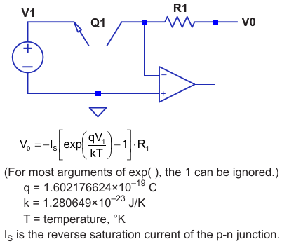

The typical anti-log circuit …
The typical anti-log circuit has uncertainties related to the reverse current, I
S
, and is sensitive to temperature

A temperature-compensated, calibration-free anti-log amplifier
Figure 1. The typical anti-log circuit has uncertainties related to the reverse current, I
S
