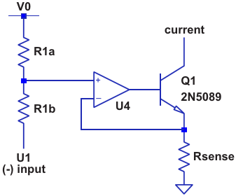

Split R
1
of Figure …
Split R
1
of Figure 4 into R
1A
and R
1B
; also add U
4
, R
SENSE
, and a 2N5089 transistor to produce a current source output

Figure 6. Split R
1
of Figure 4 into R
1A
and R
1B
; also add U
4
, R
SENSE
