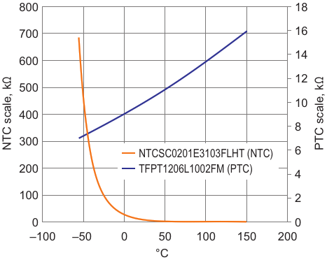

A comparison of a …
A comparison of a highly non-linear NTC and a nearly linear PTC

Figure 3. A comparison of a highly non-linear NTC and a nearly linear PTC
