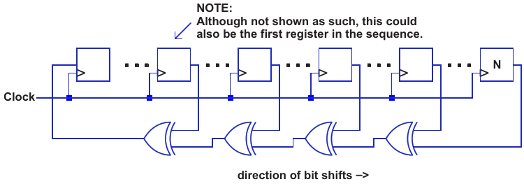

The general form of an MLS generator. A reference lists a table of 2 to 5 specific taps for register lengths from N = 2 to 32 to produce repeating sequences of length 2N-1. Register initialization must include at least one non-zero value. The a

The general form of an MLS generator A reference lists a table of 2 to 5 specific taps for register lengths from N = 2 to 32 to produce repeating sequences of length 2 sup N /sup -1 Register initialization must include at least one non-zero value The a
