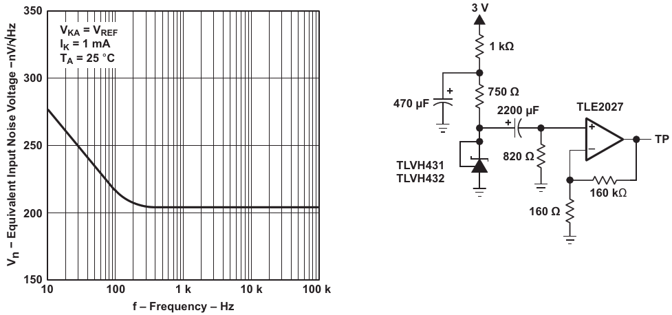

The equivalent input noise …
The equivalent input noise and test circuit for the TLVH431B (Figure 5-9 in the part's datasheet)

Figure 5. The equivalent input noise and test circuit for the TLVH431B (Figure 5-9 in the part's datasheet)
