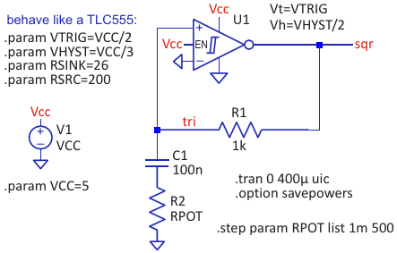

Hacked Schmitt trigger oscillator with an expanded Figure 1 circuit that includes R2=RPOT in series with C1

Figure 5. Hacked Schmitt trigger oscillator with an expanded Figure 1 circuit that includes R2=RPOT in series with C1
Figure 6. The typical triangle wave input with the output now reaching very high frequencies without excessively loading V(OUT)
