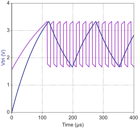

The typical triangle wave input with the output now reaching very high frequencies without excessively loading V(OUT)

Figure 6. The typical triangle wave input with the output now reaching very high frequencies without excessively loading V(OUT)
