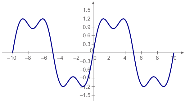

A plot of the fundamental and third harmonic begins to resemble a square wave

Figure 3. A plot of the fundamental and third harmonic begins to resemble a square wave
