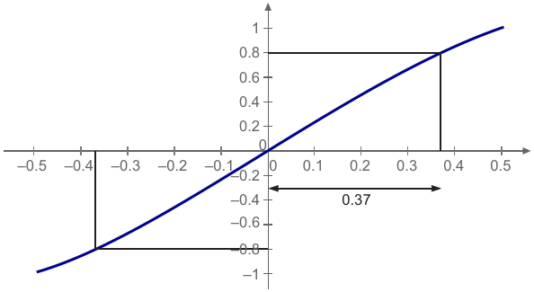

An expanded time scale …
An expanded time scale shows the rise time of the 5th harmonic waveform

Figure 6. An expanded time scale shows the rise time of the 5th harmonic waveform
