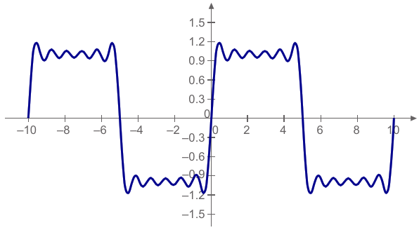

A plot of the waveform including frequency content up to the 11th harmonic gets considerably closer to looking like a square wave

Figure 5. A plot of the waveform including frequency content up to the 11th harmonic gets considerably closer to looking like a square wave
