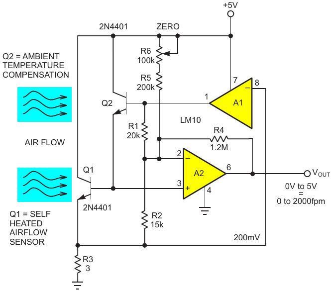

Nonlinearities of Darlington airflow sensor and VFC compensate each other
Figure 1. The TO-92 junction temperature delta versus air speed at 320 mW showing the nonlinear relationship between airflow and sensor temperature
Figure 2. The self-heated Darlington thermal airflow sensor
