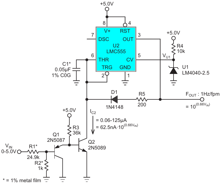

Nonlinearities of Darlington airflow sensor and VFC compensate each other

Figure 3. The nonlinear VFC is shown, with U1 configured in a 555 astable topology and a V
IN
resistor network, providing a solution for the previous nonlinearity
Figure 4. The linearized VFC airflow response (blue) where the increasing rate of Hz versus fpm cancels the nonlinear effects of King's Law to yield a 1 Hz = 1 fpm calibration

Figure 6. The anti-log nonlinear VFC
Figure 7. The anti-logarithmic linearization of Darlington airspeed sensor
