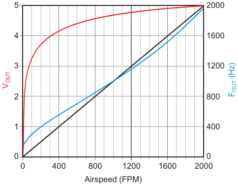

The linearized VFC airflow response (blue) where the increasing rate of Hz versus fpm cancels the nonlinear effects of King's Law to yield a 1 Hz = 1 fpm calibration
