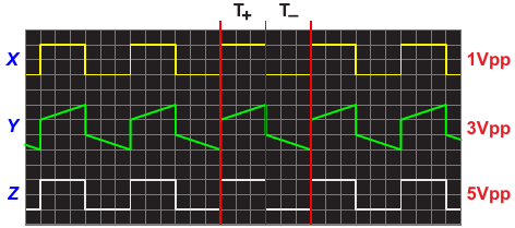

Various conversion signals found …
Various conversion signals found at circuit nodes X, Y, and Z

Another weird 555 ADC
Figure 1. Op-amp A1 continuously integrates the incoming V
IN
signal, thus minimizing noise. Conversion occurs in alternating phases, T- and T+. The T-/T+ phase duration ratio is independent of the RC time constant, is therefore insensitive to C1 toleranc
Figure 2. Various conversion signals found at circuit nodes X, Y, and Z
