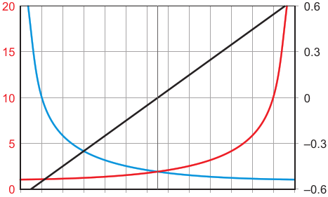

, Red = T+ duration in ms, Blue = T- duration, C1 = 0.001 µF

signal, thus minimizing noise. Conversion occurs in alternating phases, T- and T+. The T-/T+ phase duration ratio is independent of the RC time constant, is therefore insensitive to C1 toleranc

Figure 3. Black = V
IN
