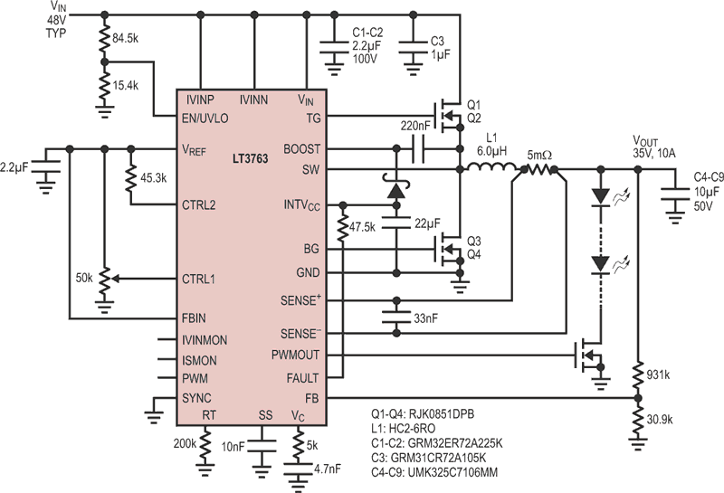

48 V Input to 35 V Output, 10 A LED Driver Optimized for Efficiency
60 V, Synchronous Step-Down High Current LED Driver
Figure 1. 48 V Input to 35 V Output, 10 A.

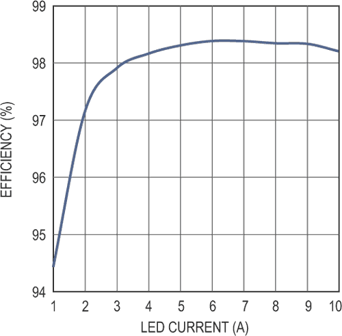

Figure 1 shows a design that delivers 350 W output power to drive up to seven LEDs in series from a 48 V source. At this high power level, dissipated power is a major concern, so high efficiency is critical. Each 1% of efficiency improvement reduces the loss by 3.5 W – significant if the total power loss budget is less than 7 W. This circuit is optimized to operate with 98.2% efficiency at full load – Figure 2 shows the efficiency reaching 98% when LED current is above 3 A and peaking at 98.4% at ~6 A.
Figure 2. Efficiency of the 48 V Input to 35 V Output Circuit.
At high voltage, the switching losses of the MOSFETs and the inductor outweigh conduction losses. The switching frequency is set to 200 kHz to minimize switching losses while maintaining small solution size. Running at full load, this circuit’s hot spot occurs at the top MOSFETs, which settles at less than 50 °C temperature rise – a very comfortable range for the MOSFETs.

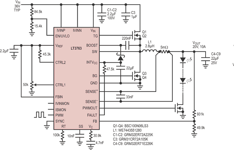

36 V Input to 20 V Output, 10 A LED Driver with Fastest PWM Dimming
PWM LED dimming is the standard dimming method for high power, high performance lighting applications. Fast LED current response to a PWM signal is important in image-producing applications, such as DLP projectors. Figure 3 shows the LT3763 in an application optimized for fast LED PWM dimming.
Figure 3. 36 V Input to 20 V Output, 10 A.

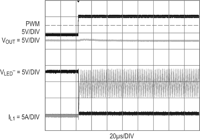

To achieve fast LED current response to the PWM signal, the LT3763 includes many innovative features. For a given input voltage, the smaller the inductance, the faster the inductor current ramps up, which translates to faster LED current response. This circuit takes only a few microseconds to reach full LED current from zero current when a PWM dimming signal is turned on. Figure 4 shows the performance in the PWM dimming application. Efficiency is 97% at full load.
Figure 4. PWM Dimming Performance of Figure 3 Circuit.
