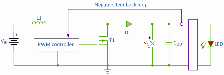

As illustrated in Fig. 1, the input of a boost converter is physically connected to its output through the boost inductor (L1) and boost diode (D1). Consequently, a short condition on the output can saturate the boost inductor and cause a current spike sufficient to damage the boost diode. Worse yet, the short can also disrupt everything connected to the input – including the pulse-width- modulation (PWM) controller. Clearly, some form of circuit protection is necessary in using this topology to power remote LEDs.

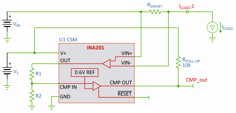

The current shunt monitor INA201 (CSM) is a precision, high-gain differential current-sense amplifier often used to monitor input and output current [1]. Fig. 2 illustrates the typical configuration. This particular device integrates an open drain comparator that can be programmed to trip, latch, and reset at a preprogrammed line current.
Protect an LED driver against output shorts to ground
Figure 2. A current shunt monitor component adds protection.
The output of the comparator can be used to control an external MOSFET switch that can interrupt a load short within a few microseconds. In addition to interrupting input current under a fault condition on the output, the analog output can be used to address the so-called “negative input impedance” of a switching regulator that will cause input current to increase as the input voltage decreases.

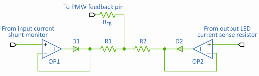

Clamping the input can be achieved by connecting the input current with the output current in a logical “or” configuration. The goal is to create a composite feedback signal that drives the PWM controller as depicted in Fig. 3. The CSM then overrides the output current feedback and forces the LED current to decrease as the input voltage drops below a preset level, thereby limiting the input current.

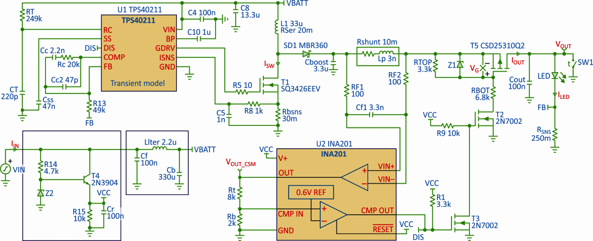

Fig. 4 illustrates the circuit implementation of a boost converter LED driver with output short-circuit protection. The Osram Opto Semiconductors Ostar LED shown in the circuit is a device targeting automotive headlamp applications and is actually a monolithic, five-die LED on an insulated metal substrate (Fig. 5). The device has a surge current rating of 2 A for less than 10 μs and a typical forward voltage of 18 V at 1 A. The DC/DC boost converter TPS40211 [2] senses the forward LED current at the feedback pin and adjusts the output voltage sufficiently to regulate the LED current. The LED current is set by the sense resistor (RSNS) and its value is proportional to the internal bandgap reference (VREF) of the PWM converter (RSNS = VREF/ILED). Using a boost converter with a low reference voltage facilitates higher converter efficiency and reduces component thermal stress.
Figure 4. The LED boost driver circuit with shorted load fault protection.
Although inherently capable of achieving an operating life of over 50,000 hours, the LED is sensitive to temperature and electrical overstress and their dynamic impedance characteristic often challenges switching regulator component selection and control loop design. As such, a simulation of the circuit in Fig. 4 was developed to analyze the complexities of the LED driver/protection circuit and anticipate circuit behavior under varied operating conditions.
The PWM controller chosen for this analysis has a feedback reference voltage of 0.26 V. So, at 1 A of LED current, only 0.26 W is dissipated in the LED sense resistor. Because the CSM has a gain of 50, a much smaller-value sense resistor is used for sensing the output current. When the current through the CSM shunt resistor exceeds a programmed limit set by the CSM sense resistor, CSM gain and comparator threshold (R, R), the PMOS pass transistor interrupts load current – acting as an electronic circuit breaker.
The latched output can be reset by toggling the RESET pin low. However, for the purpose of this article, the RESET has been disabled to examine the speed of response. The response speed and peak currents depend on many variables. These include component selection, CSM bandwidth, noise filter, output capacitance, FET selection, and output boost inductor. Collectively, these factors affect the converter’s output impedance. To accurately assess behavior, we ran the simulation with a maximum time step set at 50 ns, and the DC relative tolerance set to 0.001%. The analysis was done in TINA-TI, a free Berkeley SPICE 3f5 compatible simulator. The 5-ms simulation of the boost converter operating at 300 kHz runs start-up to steady state in just under 30 seconds.

The CSM can be placed on the input or output of the boost converter. In this simulation, the CSM is placed on the output where it senses current through a 10-mΩ shunt placed in series with the output PMOS pass element (T5). Depending on placement of the CSM, the circuit will protect against internal and/or external short conditions. However, the CSM must be designed with sufficient common mode range (CMR) under all operating conditions.

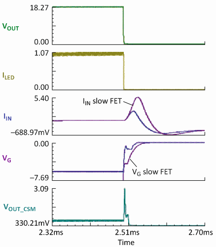

The simulation result is presented in Fig. 6. VG is the control voltage to the PMOS FET and is set at –6 V under normal conditions. Optimization is necessary depending on the threshold voltage of the FET, gate charge, and saturation characteristics. Minimizing voltage on the gate can improve reaction time, and the pull-up resistor should be selected to minimize the interrupting period. Note that the input current and gate voltage are shown with a high gate charge (purple), and low gate charge (blue) MOSFET.

It is evident that the lower gate charge device minimizes current seen at the input. Selecting a MOSFET and gate drive circuit to achieve optimal response are important considerations, as is limiting the di/dt and satisfying the MOSFET safe operating requirements. These are complex design considerations not easily analyzed; therefore, they are best simulated and confirmed on the bench.
Specialized test software is available on some oscilloscopes such as Tektronix products to calculate switch power loss against MOSFET safe operating curves. Simulation suggests a response less than 2 μs in duration, resulting in an input current of less than 6 A before the current is interrupted. The selection of the interrupting FET will impact the peak input and output current. High-performance, hot-swap controllers driving high side NMOS devices are another option and able to achieve interrupting times of less than 250 ns. These devices are optimized for backplane hot card insertion but may provide a higher-performance solution.
