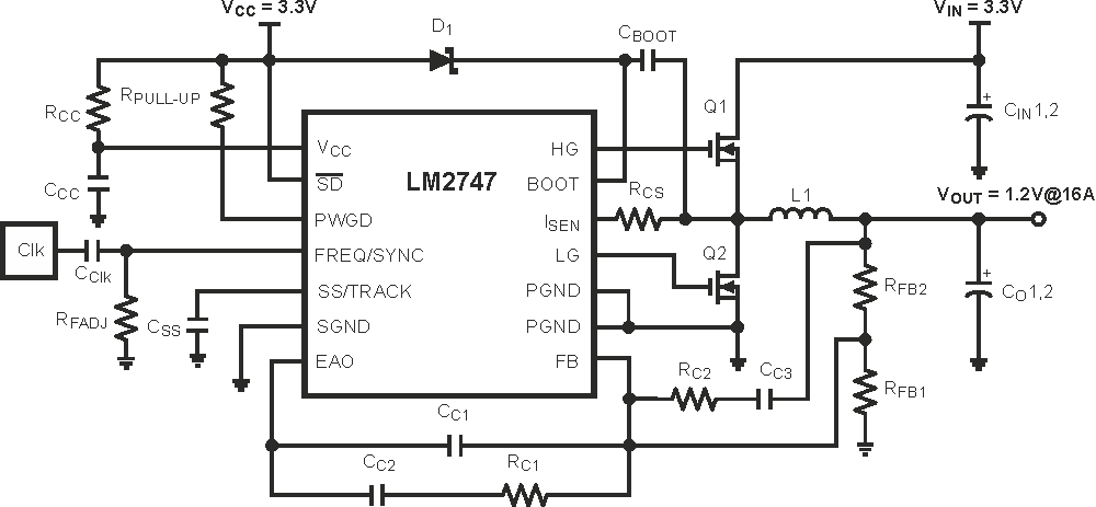

Figure 1. Example DC-DC converter with SYNC input.

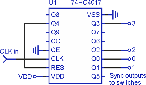

Fortunately, many IC and modular converters these days have a SYNC input pin. The LM2747 is a good example of a suitable controller IC (Figure 1). The synchronizer is a CMOS decoded counter, such as the 4017/4022, or 74HC4017 (Figure 2). This is driven with a clock signal equal to the converters' operating frequency times the number of converters. Connect the first unused counter output to its RES/MR (master reset) pin to set the correct count length.

Figure 2. Synchronization circuit wired for four converters.
