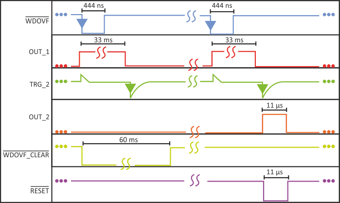

This timing diagram for two separate watchdog events shows the reset pulse being held off and not resetting the hardware for the first event and then a reset pulse that occurs after a predetermined delay for the second event.
Figure 2. This timing diagram for two separate watchdog events shows the reset pulse being held off
Figure 2 shows the timing for two separate watchdog overflow events. The first event shows the reset pulse being held off and not resetting the hardware, and the second shows the reset pulse occurring after a pre-determined time delay. The times shown represent the TH calculations using the RC component values from Figure 1 and the duration of the watchdog-overflow pulse from an Atmel microcontroller. For the first timer:

Series capacitor C3, pull-up resistor R3, and diode D1 ensure that the second timer’s trigger, TRG_2, will remain high until a high-to-low transition occurs on timer one’s output, OUT_1. The pull-up resistor recharges the series capacitor to the supply voltage after the high-to-low transition on OUT_1. The RC time constant associated with the pull-up resistor and series capacitor was chosen to be less than the output-high period of the second timer. The diode clamps the input voltage on the second timer’s trigger pin to the supply voltage.
In this example, when the watchdog-overflow event occurs, the microcontroller is configured to send a relatively short active-low pulse to a dedicated pin and create an internal interrupt. Once the event takes place, the code jumps to the interrupt-service routine and performs several specific lines of code. These include clearing the interrupt flag, holding off the pending hardware reset by asserting the – /WDOVF_CLEAR I/O pin, saving debug data to NVM, disabling interrupts, and resetting the watchdog-overflow timer.
In this case, the hardware-watchdog event, along with other project-dependent information, is stored in NVM for later review. When the watchdog timer expires a second time, it bypasses the interrupt-service routine and ultimately resets the hardware.
