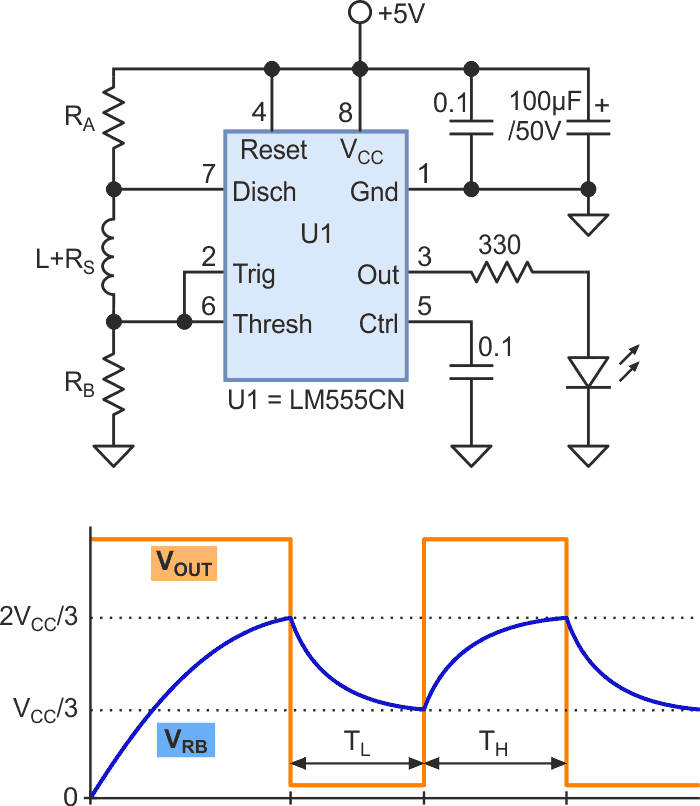

The 555 multivibrator circuit has become a default choice of many hobbyists and even professionals in the past 50 years. Its pair of equations for frequency and duty cycle easily gives capacitor-resistor combinations which satisfy the required output. But there could be situations when using inductor-resistor values instead would be a better solution. An example is a high-temperature environment which can shorten the useful life of electrolytic capacitors. In that case, the circuit in Figure 1 is worth considering.
At start-up, the voltage at pin 2 (VRB) is zero and the output (VOUT) at pin 3 is high. During this time the LED is on and the discharge transistor (pin 7) is open. The inductor current increases exponentially until VRB reaches 2VCC/3. This is sensed by the threshold terminal (pin 6) which causes VOUT to go low. The discharge transistor turns on and the LED turns off.
| Figure 1. | A 555 multivibrator circuit that uses inductor-resistor values. |
Pin 7-to-ground effectively provides a low-resistance path (RON) which causes the inductor current and VRB to gradually decrease towards zero. When pin 2 senses that VRB has fallen below VCC/3, VOUT goes high again, the LED turns on, and pin 7 reverts to its open state.

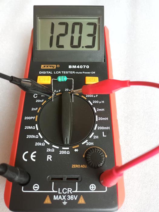

To test these ideas, I picked the components listed in Table 2 and used an LCR meter to measure their actual characteristics (Figure 2). I plugged the values into the spreadsheet to predict TH, TL, and other output characteristics. The results of these calculations are listed in Table 3.

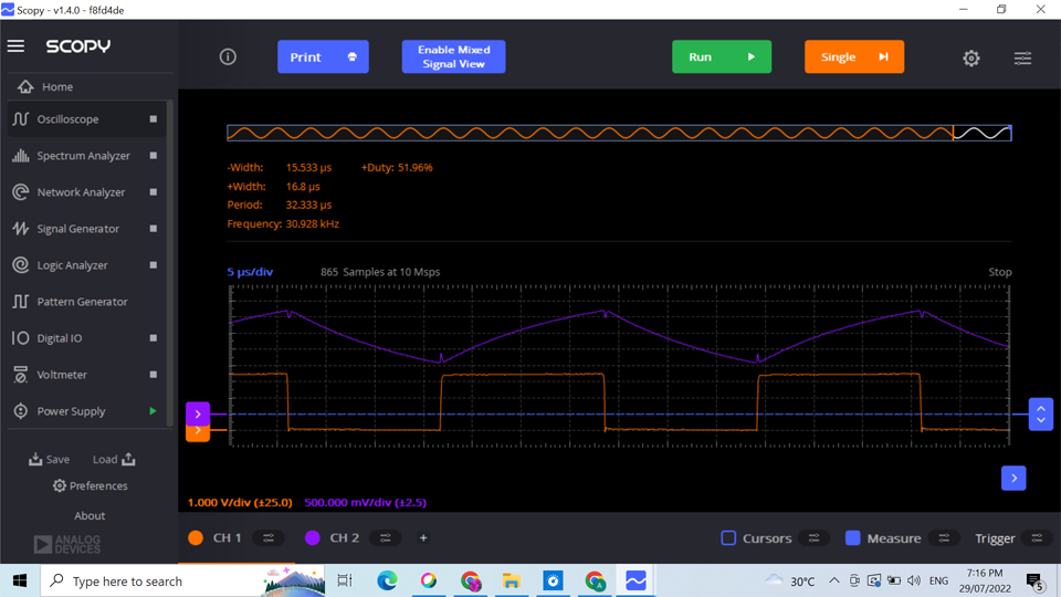

I used the ADALM2000 module (from Analog Devices) to power the experimental set-up (Figure 3a) and get the waveforms (Figure 3b) from pins 2 and 3 of the timer IC. The measurements show that Equation 1, in tandem with those of Table 2, closely models the behavior of the proposed circuit. There were droops and spikes noted for VRB during the transitions at pin 7, mostly due to the long power lines. These were mitigated by the pair of capacitors placed very close to pin 8.
