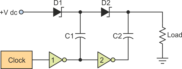

Figure 1 shows the basic charge pump that’s connected as a voltage doubler. The operation is a two-step charge-discharge cycle where “flying” capacitor C1 charges then discharges into C2. When the clock drives the output of inverter 1 low, D1 is forward-biased, charging C1 to V dc. D2 is off at this time. Then the clock drives the output of inverter 1 high to V dc.
The Charge-Pump Option to LDO and Inductor-Based Regulators
Figure 1. The basic voltage doubler configuration is the most
common charge pump circuit.
The charge on C1 is now in series with V dc from inverter 1. The output of inverter 2 is low, so D2 is forward-biased and C2 charges to 2 V dc. The output across the load is 2 V dc, less the diode forward drops, and any losses in the inverters. Schottky diodes are preferred because of the lower forward-voltage drops and high switching speeds. Clock speeds can be anywhere in the 10-kHz to 2-MHz range. If more diode and capacitors segments are added, the voltage can triple or quadruple (or even higher).

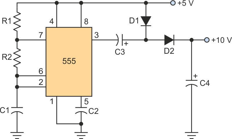

Figure 2 shows some examples of discrete charge pumps using the popular 555 timer IC. Figure 2a is a voltage doubler. The 555 timer operates as an astable multivibrator with a frequency set by R1, R2, and C1. The rectangular wave output at pin 3 switches from +5 V to near ground. When pin 3 is low, C3 charges through D1 to +5 V. When pin 3 goes to +5 V, D2 conducts, connecting the +5 V from the timer in series with the +5 V on C3, thereby charging C4. The output is +10 V, less the diode drops.

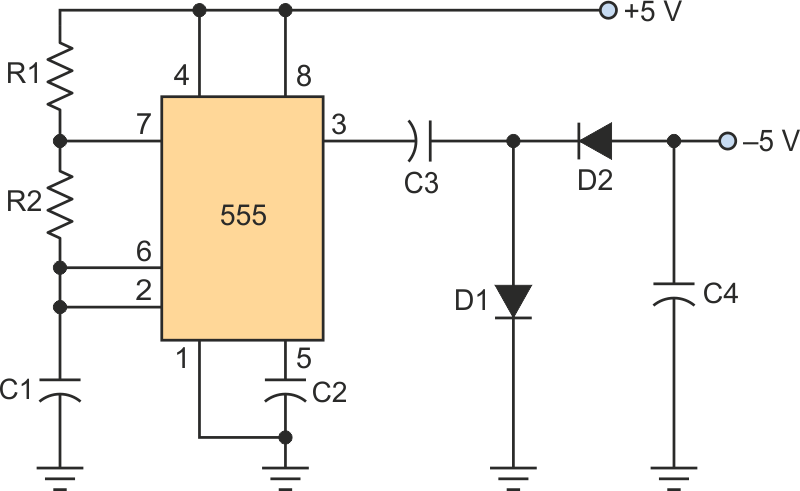

The charge pump can be configured as a voltage inverter, as seen in Figure 2b. With pin 3, the +5-V C3 capacitor charges through D1. When pin 3 goes to ground, D2 is forward-biased and C3 discharges into C4. Here, the +5-V supply is converted into an output of about –5 V, less the diode drops. Such an inverter circuit is useful when there’s a need for a negative supply. An example is when plus and minus supplies are needed for an op amp.

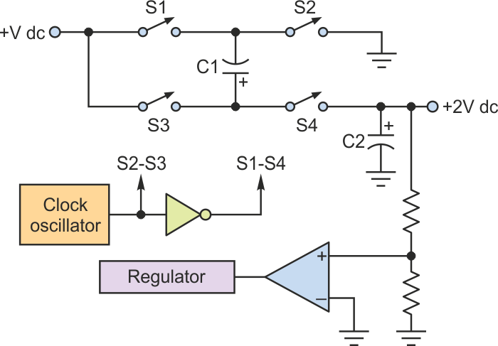

Fig. 3a shows the classic voltage-doubler configuration. With S2 and S3 closed and S1 and S4 open, “flying” capacitor C1 charges to the input voltage V dc. On the next half of the cycle, S2 and S3 open while S1 and S4 are closed. C1 is connected in series with the input voltage, and the combination charges C2. The output is 2 V dc, less the MOSFET drops. Note the feedback voltage divider that provides the regulation.

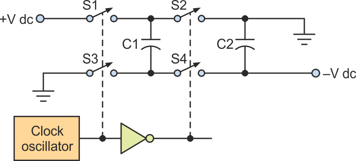

An inverting version is shown in Fig. 3b. With S2 and S3 closed and S1 and S4 open, “flying” capacitor C1 charges to the input voltage V dc. On the next half of the cycle, S1 and S3 open while S2 and S4 are closed. C1 discharges into C2. With the upper end of C2 grounded, the output at the other end is –V dc.
