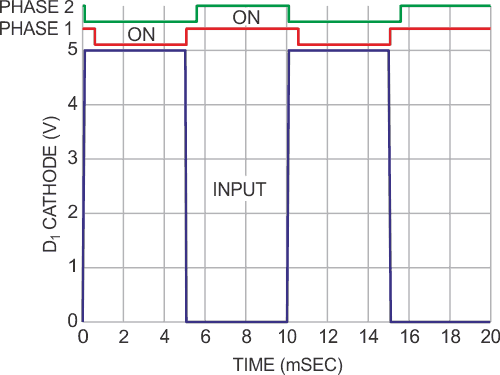

Each Schmitt trigger inverter is driven during one half-cycle through a diode. The RC delay occurs during the alternate half-cycle. Equal-value resistors R1 and R2 serve alternatively as delay elements and gate-coupling resistors. The waveform in Figure 2 shows the result. For the two out-of-phase half-cycles, leading edges are delayed equally with respect to the input transition, and trailing edges are coincident with the transition within about one gate delay. If you need equal polarity “on” half-cycles, insert an inverter in one of the two phase outputs. Alternatively, if biphase drivers, such as those for driving coupling transformers, will follow this circuit, merely interchange the outputs of one of those drivers to effect the inversion.
Figure 2. For the two out-of-phase half-cycles, leading edges are delayed
