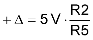

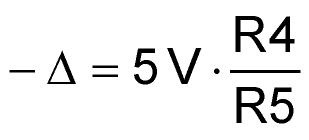

Output regulation is provided by the charge pump control from the temperature compensated discrete transistor comparator Q1:Q2 for U1c on the negative rail and Q3:Q4 for U1b on the positive. Average current draw of each comparator is ~4 µA, which helps achieve those low power consumption figures mentioned earlier. Comparator voltage gain is ~40 dB = 100:1.
The comparators set beyond-the-rails voltage setpoint ∆s in ratio to +5 V of:
for the negative rail = –250 mV for values shown
for the positive = +250 mV for values shown
Note that the output of the Q1:Q2 comparator is opposite to the logic polarity required for correct U1c control. Said problem being fixed by handy inverter U1d.
