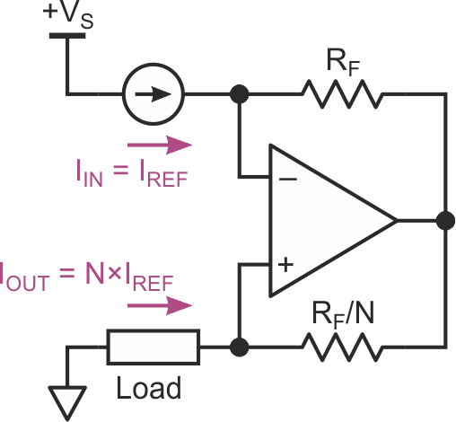

The resistor-programmable current source/sink in Figure 1 illustrates the basic topology, taking advantage of tightly matched on-chip resistor ratios instead of relying on absolute tolerances.
IREF can be increased or decreased to the load depending on N.
Figure 1. IREF can be increased or decreased to the load
depending on N.
The IIN current source gives rise to a reference voltage across RF at the op-amp inverting input. The same potential is found across the RF/N resistor, so that an output current of N × IIN will be generated.

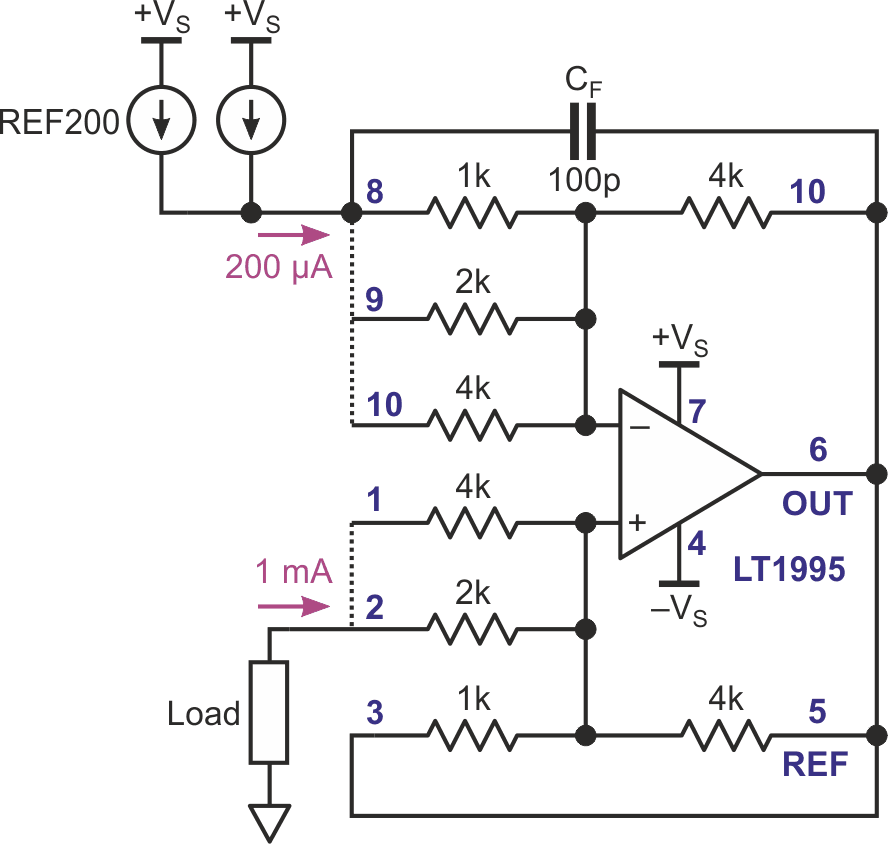

Figure 3 shows a similar application based on the LT1995 chip and used to increase the output current, in this case, summing the currents from the two sections of the REF200 and multiplying by a factor of five.
The absence of an internal compensating capacitor in the LT1995 could induce instability. As experimentally verified, the circuit of Figure 3 will oscillate at a few megahertz if a 33-100 pF capacitor is not inserted as indicated.
Table 1 summarizes the connections for IOUT/IIN ratios between 2 and 7.
Table 1. Connections for IOUT/IIN ratios
between 2 and 7
IOUT/IIN
P1
pin 1
P2
pin 2
P4
pin 3
REF
pin 5
CF
2
OUT
Load
33 pF
3
OUT
Load
OUT
100 pF
4
Load
OUT
33 pF
5
Load
OUT
OUT
100 pF
6
Load
OUT
OUT
100 pF
7
Load
OUT
OUT
OUT
1 nF

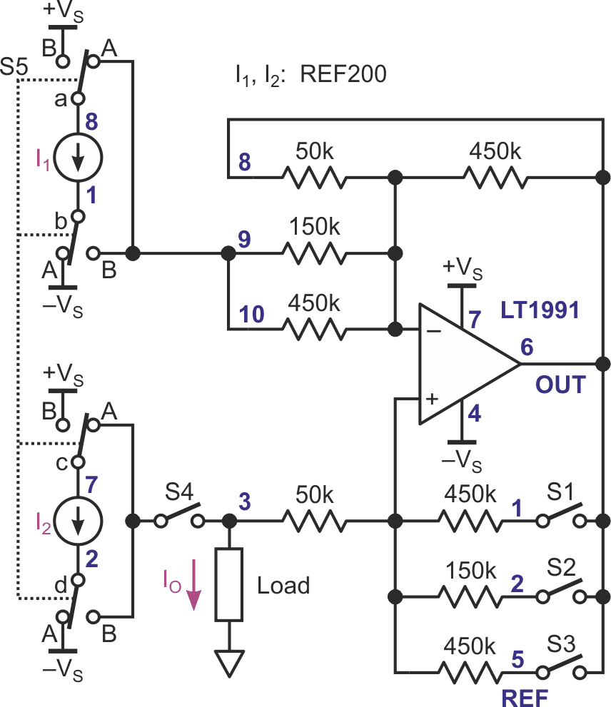

Figure 4 shows an LT1991-based programmable current source where internal resistors are ratioed 1:3:9.
An LT1991 is used to source/sink from 10-90 µA in 10 µA steps.
Figure 4. An LT1991 is used to source/sink from 10-90 µA in 10 µA steps.
The circuit can generate an output of 10 – 90 µA in steps of 10 µA. For currents up to 50 µA, the principle is the same as before. Above 50 µA, the second current reference in the REF200 is used to superimpose 100 µA onto the load to obtain the desired output current. Table 2 illustrates switch settings for the various current levels.
Table 2. Switch settings for the various current levels
lOUT (µА) S1 S2 S3 S4 S5
Source Sink
10 ON OFF OFF OFF A B
20 ON OFF ON OFF A B
30 OFF ON OFF OFF A B
40 ON ON OFF OFF A B
50 ON ON ON OFF A B
60 ON ON OFF ON B А
70 OFF ON OFF ON B А
80 ON OFF ON ON B А
90 ON OFF OFF ON B А
