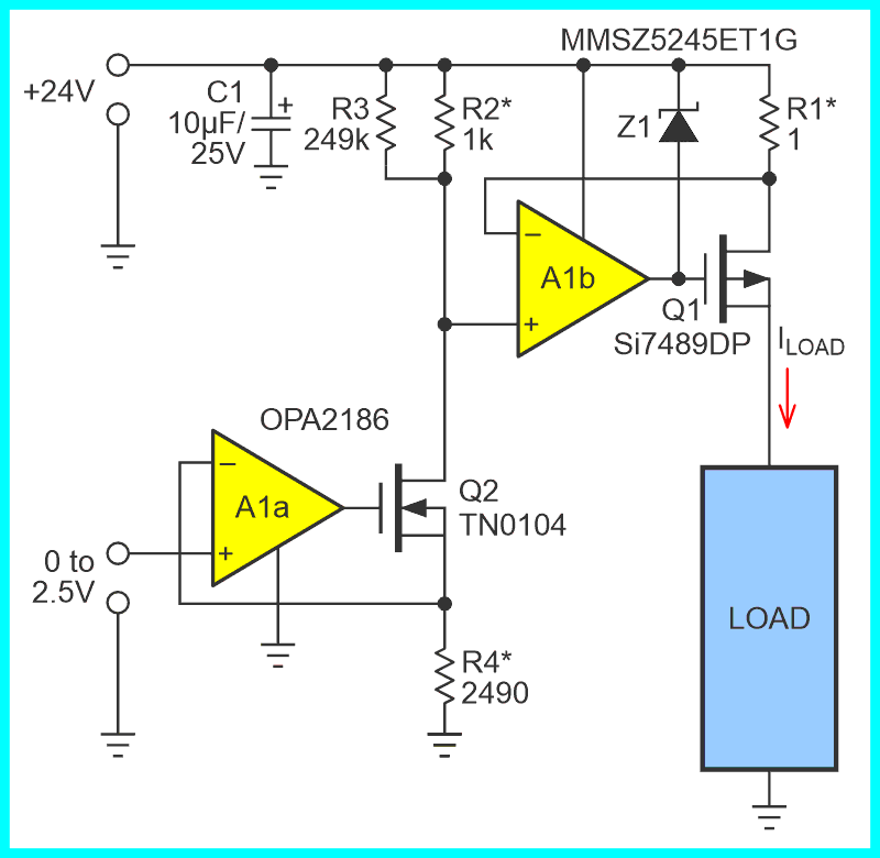

Current source without overtemperature protection
Figure 1 shows what I started with: A simple, straightforward, accurate, 0 to 1 A current source programmed with 0 to 2.5 V. It needs only about 1.25 V of headroom, consisting mostly of the drop of current sense resistor R1 (plus a modicum more from the RON of Q1), thus fixing the problem I started out to solve.
An improved efficiency precision current source has no overtemperature protection. With no protection, if the Q1 heatsink is inadequate, high power or ambient temperature might destroy it.
Figure 1. An improved efficiency precision current source has no overtemperature protection. With no protection,
But sadly, in fixing one problem, I created another.
The same elimination of LM3x7s that reduced the headroom requirement also eliminated overtemperature protection. Without a substantial external heatsink, the Si7489DP FET is rated for only ~6 W at 25 °C. If power dissipation, ambient temperature, or both happen to go higher, there’s now nothing to prevent Q1 from being cooked.

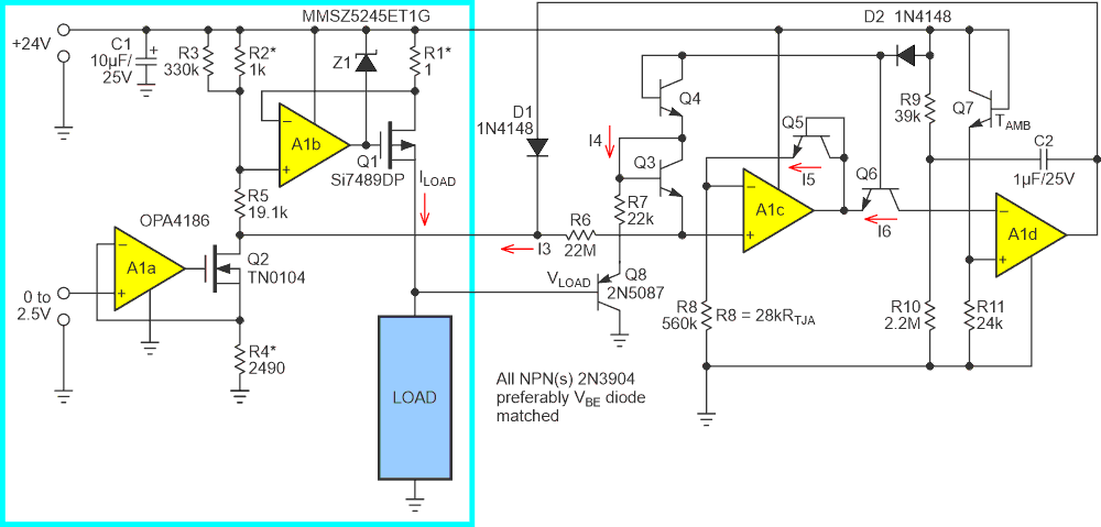

Current source with overtemperature protection
So now I wondered what might be done about that. Figure 2 shows what said wondering (wandering?) inspired.
External junction temperature protection for the Q1 pass transistor. Since Q1's internal junction temperature can't be directly measured, it must be inferred from power dissipation, junction to ambient thermal resistance, and ambient temperature. If it tops 150 °C, A1d stops the show.
Figure 2. External junction temperature protection for the Q1 pass transistor. Since Q1’s internal junction temperature can’t be directly
What was needed was an external version of the now missing LM3x7’s internal junction overtemperature cutoff. Of course, the challenge with implementing an external junction temperature limiter is that internal transistor junctions are a second cousin to the classic Schrodinger’s cat.
Well, maybe not exactly. Unlike the famous quantum kitty, whose temperature (whether body or room) is theoretically unknowable. Junction temperature, while difficult to directly observe, might at least be calculated.
And in fact, this is what the right-hand half of Figure 2 does.

The analog arithmetic
Figure 2’s circuitry performs analog arithmetic by relying on the nifty 17th-century invention of John Napier for multiplication and division: adding and subtracting logarithms. Here’s how the Figure 2 circuitry divides (and multiplies!) up the work.
Q3’s VBE is the logarithm of the Q1 current programming signal sensed via R6. Meanwhile, Q4’s VBE logs the voltage across Q1 monitored by Q8 and R6.
Q3 and Q4 are connected in series, so their log voltages sum. About 400 years ago (now that’s really legacy technology!) Napier showed that adding logs is equivalent to multiplication. So, the sum of VBE’s becomes the IJVJ product term in the TJ math.
The IJVJ signal is applied to A1c’s non-inverting input, which then subtracts Q5’s VBE present on the inverting input. Because subtracting logs equates to division (thanks again, Johnny!), if R8 is properly scaled, this division provides the SJA normalization term for RJA. The quotient yields the log of junction temperature rise above ambient.
The antilog transistor Q6’s collector current, in concert with the R9/R10 network (at long last!) converts A1c’s output to a 2 mV/°C junction temperature signal. That’s summed by A1d with Q7’s ambient temperature signal.
When the sum bumps against Q1’s 150 °C safety limit, A1d’s output ramps positive, overriding the programmed source current to a safe value.
Which you might say is the cat’s meow.
An afterthought
It belatedly occurred to me that an alternate (and probably more accurate) plan than having Q7 sample ambient temperature would be to thermally attach (i.e., intimately cuddle) it to Q1’s case and have it report that temperature that inherently includes heat sink effects. Then we can use the thermal impedance from junction to case given in Q1’s data sheet (i.e., RJC instead of RJA) = 1.5 °C/W max for the Si7489DP.
R8 in that case would then become 28,000 × 1.5 = 42k.
