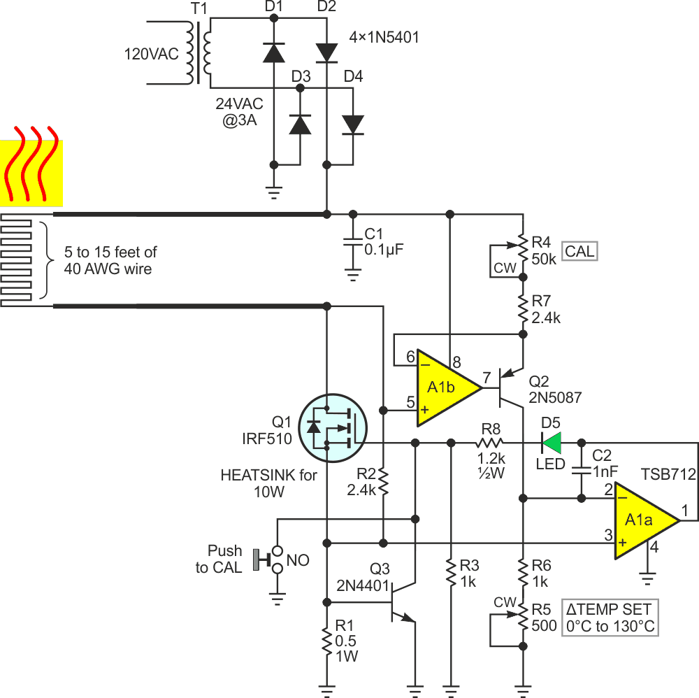

Figure 1 shows a design idea that achieves it.
| Figure 1, | A switch mode thermostat efficiently heats melded copper wire sensor/heater. |

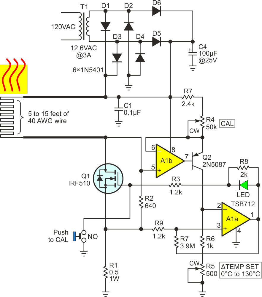

Figure 1 shares much in common with a linear sibling (Reference 1) whose schematic is found in Figure 2.
| Figure 2, | Linear mode hot wire thermostat that uses the tempco and I2R heating of 40 AWG copper wire as a melded sensor/heater. |
Their respective interfaces with a copper wire melded heater/sensor are essentially identical. Where they differ is the way op-amp A1a controls Q1.
In Figure 2, temperature dependent voltage differences between R1 and R5+R6 are linearly amplified by A1a and applied to Q1’s gate to linearly force hotwire heating to match the setpoint dialed in on R5. The result is good temperature control, but also up to 10 W of dissipation on Q1.
In Figure 1, by contrast, positive feedback around A1a via R7 forces the amplifier to latch Q1 fully ON or OFF in response to the same error signals. This simple difference improves heating efficiency enough that, unlike Figure 2, Figure 1’s Q1 needs no heatsink and the overall circuit runs from only half the supply voltage.
Heating efficiency depends on hotwire length, and ranges from 83% for 5 feet, to 94% for 15. These numbers compare well to the linear version, that maxes out at about 50%.
Meanwhile, the calibration sequence remains the same for both switcher and linear:
