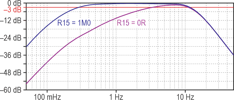

Figure 2 shows the response to changes in air pressure with R15 set to both its maximum and minimum values. While these are LTspice-derived traces, they closely match the real-world measurements. Compare the top, red trace with Figure 2 in Part 1.
The calculated frequency responses of the circuit with the limiting values of R15.
Figure 2. The calculated frequency responses of the circuit with the limiting values of R15.

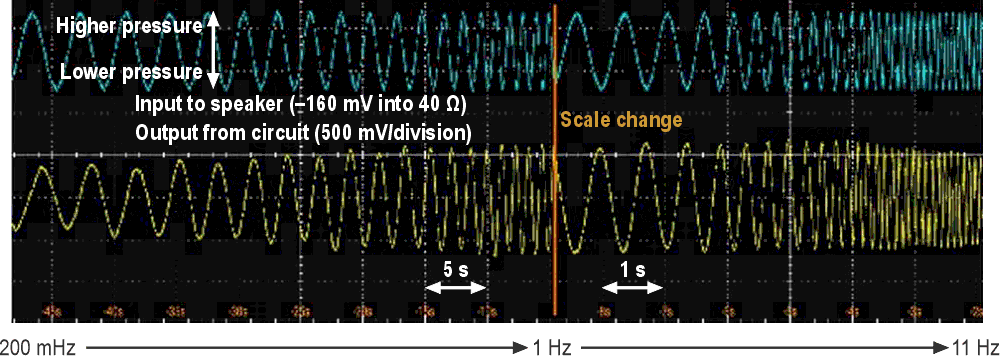

Actual results are shown in Figure 3. These used the test rig described in Part 1, and were taken with R15 set for maximum bandwidth. Like Part 1’s Figure 5, with which it can be compared, it was scanned manually, so don’t trust the frequency scale to be truly logarithmic. As before, the trace wanders vertically because of flicker or 1/f noise from the JFET, but the overall response and linearity are both clear.
Measured response using a real microphone in the pressure-chamber test rig.
Figure 3. Measured response using a real microphone in the pressure-chamber test rig.

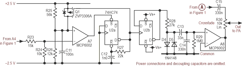

If we take the infrasonic signals and use them to modulate an audio tone, we can then hear what’s going on, or at least a proxy for it. A recent DI was for a pitch-linear VCO [2]: this DI is of course the project (or gadget) for which that was needed (or wanted).
The oscillator used here is almost identical to one of the variants in that article. It’s shown in Figure 4. We won’t describe its operation here (you can refer back for the details) but there are some changes and additions.
Frequency-modulating an audio tone lets us hear the form of the infrasonics.
Figure 4. Frequency-modulating an audio tone lets us hear the form of the infrasonics.
As before, the main part of it generates a tone whose frequency is centered at around 500 Hz and which varies by plus or minus an octave – doubling or halving the frequency – for control inputs ranging from plus to minus a volt (roughly), so that it is linear in pitch rather than frequency. That control input is of course the detected infrasonic signal.
Under extreme conditions, that signal can span the power rails – up to ±2.5 V – so it is potted down by R23 and R24. (Something non-linear in place of R24 is tempting but untried. That should allow low-level signals through almost unchanged while compressing the peaks. Perhaps two pairs of back-to-back 1N4148s, with a higher value for R23…)
The audio square wave from U2b feeds R28 and the pair of limiting diodes bridged by C13 and C14 to give a trapezoid of about a volt peak-to-peak. That may be excessive, so C13/14 also pot it down to ~100 mV pk–pk. A8 buffers the signal, R29 providing a ground path while scarcely shunting C14.
For a straightforward ~1 V pk–pk audio output, short out C13, make C14 33 nF, and eliminate R29 and pot R30. Even simpler (and cruder) would be to feed the phones directly from U2 through a 5k pot acting as a volume control. Extra filtering caps across the phones could then be added to taste.

We may want that lower signal level because it’s then comparable with the output from A2, which is the mic’s amplified wideband audio signal. R30 lets us cross-fade between that and our tones, should we want to. (And we may, a little later.) The output can now be fed to a power amp (I used a TDA7052A – not shown) and speaker or earphones (with a series resistor). With the left and right ’phones in parallel, the sound is roughly in the middle of your head; connecting them in series (out of phase) gives an “out there” effect, which can be less distracting if you also want to hear the complex soundscape of the planes, trains, and automobiles causing the infrasonics.

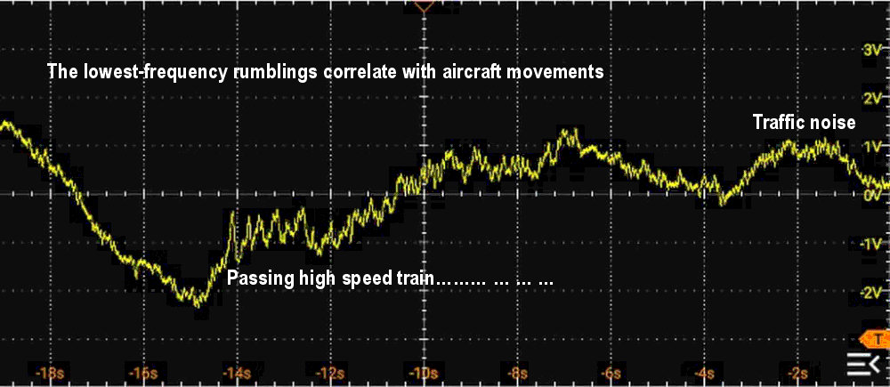

While it might be nice to include a sound file here so that you can hear the results, we will have to make do with something visual (Figure 5): a typical trace, showing a passing high-speed train a few hundred meters distant while a couple of planes much further away approach Heathrow Airport.
The effects of a nearby train, a plane or two, and some local traffic can be seen in this trace. Note the x-axis time scale.
Figure 5. The effects of a nearby train, a plane or two, and some local traffic can be seen in this trace.
