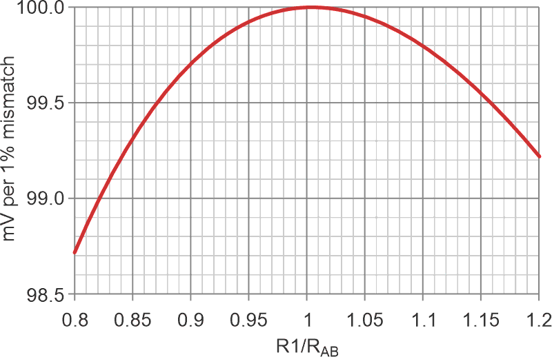

Output voltage as a function of RA/RB % mismatch is maximized when load resistor R1 is (at least approximately) equal to the nominal resistance of the resistances being matched. But because of the inflection maximum at R1/RAB = 1, that equality isn’t at all critical, as shown in Figure 2.
The output level (mV per 1% mismatch at Gain = 1) is not sensitive to the exact value of R1/RAB.
Figure 2. The output level (mV per 1% mismatch at Gain = 1) is not sensitive
R1/RAB thus can vary from 1.0 by ±20% without disturbing mismatch gain by much more than 1%. However, R1 should not be less than ~50 Ω in order to stay within A1 and U1 current ratings.
