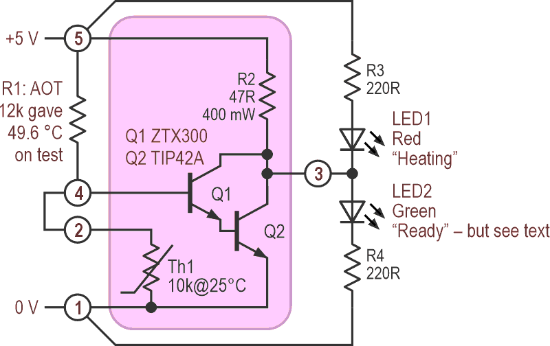

Figure 1 shows the schematic of a simple version needing only a 2-wire connection, along with two photos indicating its construction. It was slimmed down from a more complex but less successful initial idea, which we’ll look at later.
5-V ovens (some assembly required) 5-V ovens (some assembly required)
Figure 1. A simple oven circuit, heated by both R2 and Q2. The NTC thermistor Th1 provides feedback,
the set point being determined by R1. Note how critical components are thermally tied together
as they are all built onto the TO-220 package, as shown in the photos. Also note the fine lead
wires to reduce heat loss once the assembly is heat-insulated.
Both R2 and Q2 can contribute to heating. On a cold start (literally) Th1’s resistance is high so that the Darlington pair Q1 and Q2 has enough base voltage to saturate it, with (most of) the rail voltage across R2. As the assembly heats up, Th1’s resistance drops, reducing the drive to Q1/2. The rail now appears across both R2 and Q2, with the latter taking over as the main, though now reduced, source of heat. This gives a degree of proportional control, reducing the drive as the set-point is approached. That base drive depends not only on the ratio of R2 to Th1 but also on Q1/2’s effective VBE, which needs to be temperature-stabilized – as indeed it is. Consumption varies from ~90 mA when cold to ~30 mA when stable.

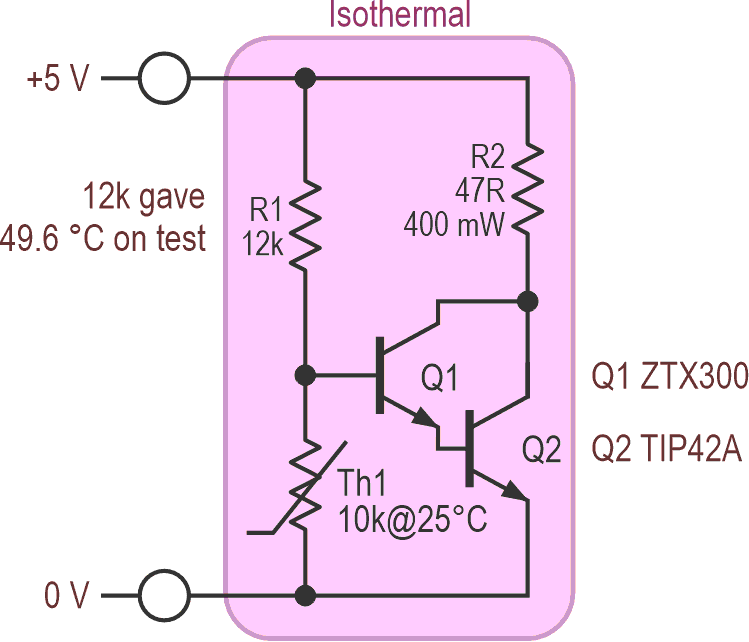

The next variant, shown in Figure 2, is electrically similar but provides access to useful circuit nodes to help monitor its performance. It was also easier to experiment with.
Figure 2. While electrically the same as Figure 1, this brings out most circuit nodes
to help with experimentation and monitoring, including the LEDs on “pin 3”.

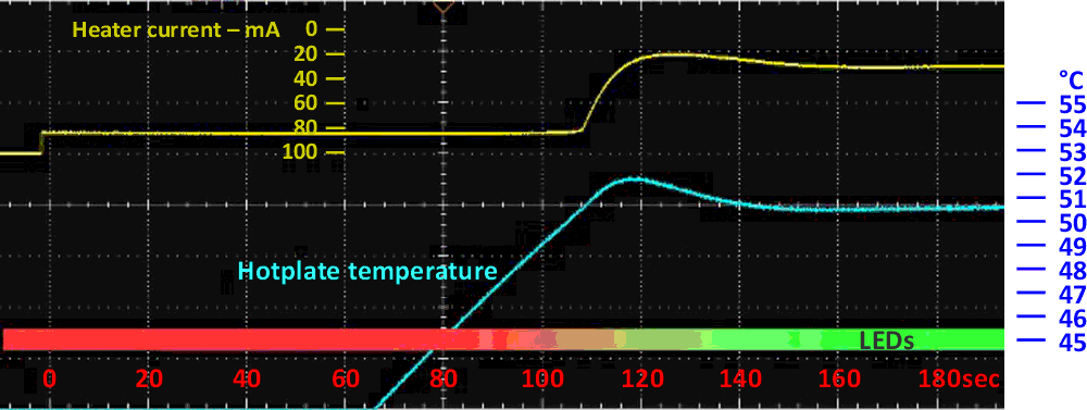

Now we can see what we’re doing! The LEDs give a simple status indication, the green one lighting when it’s close to the set-point rather than fully stable. Figure 3 shows the effect, along with traces for Q1/2’s Vcc – allowing us to read the current in the transistors and R2 – and the hotplate temperature. The latter is accurate, but the voltage and current scales are less so because they assume a precise 5-V supply and a 50-Ω load rather than the measured 4.94 V and 47 Ω plus stray resistance. This module stabilized at ~50.6 °C.
Measurements taken from Figure 2's circuit for about three minutes after a cold start.
Figure 3. Measurements taken from Figure 2’s circuit for about three minutes after a cold start.

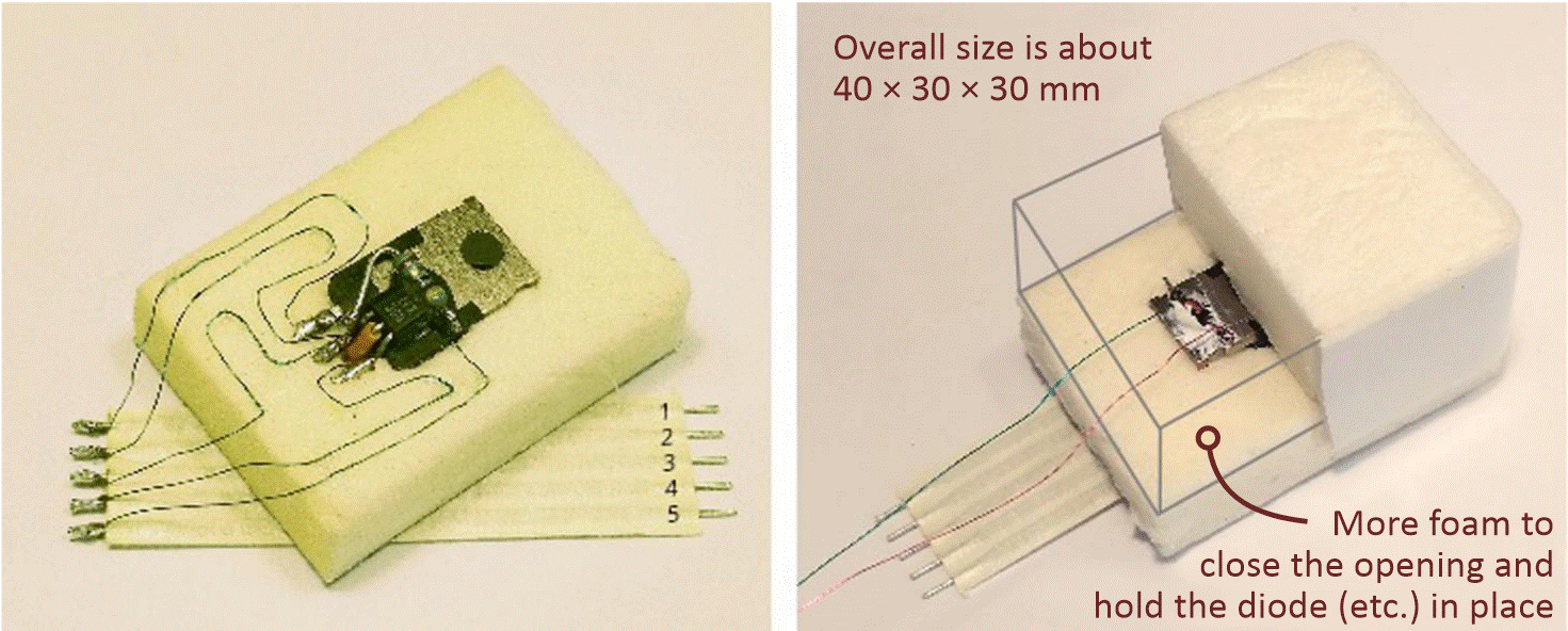

So much for the basic circuit. Now, it needs thermal insulation to keep the heat in, a block of foam being the obvious choice. But foams have widely differing thermal conductivities. Expanded polystyrene or polyethylene will work, but the foamed polyisocyanurate or similar used for wall insulation panels is around twice as good – and offcuts are often freely available from builders’ skips/dumpsters! Figure 4 shows the module from Figure 2 mounted on/in a block of it, with at least 10 mm of foam around any part of the circuit module.

The fine lead wires – 0.15 mm diameter, as used with wiring pencils – are meandered over the surface to lengthen the thermal paths. Copper has a thermal conductivity some 19,000 times greater than the foam: 384 W/m·K vs ~0.02 W/m·K. In very crude terms, for a given thermal path length and temperature gradient, a single, short 0.11-mm-diameter copper wire will leak heat at about the same rate as the entire surface area of our foam block (~6000 mm2). Ironically, perfect insulation would be bad, as the innards could never cool to recover from an overshoot. This build took 620 seconds to cool by 63% of the way to ambient.

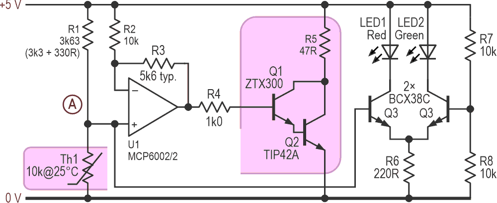

The foregoing circuits were actually simplifications of my starting point, which is shown in Figure 5. When the temperature is stable at ~50 °C, point A is at half-rail. R3 is chosen so that U1’s output will turn Q1/2 on just enough to maintain that. However, while the extra gain improves the temperature regulation, it also causes some overshoot. R3 or R2 must be trimmed to set the temperature: fiddly, and not really designable. R3 was calculated at 4k12 but needed ~5k6 in reality. That’s why I gave up on this approach.
The original circuit that suffered from overshoot. The LEDs give a too-high/too-low temperature indication.
Figure 5. The original circuit that suffered from overshoot. The LEDs give a too-high/too-low temperature indication.
The long-tailed pair of Darlingtons (Q3, Q4) sense the difference between the thermistor voltage – half the rail when stable, as noted – and a half-rail reference, so that the red LED will be on when the temperature is low, the green one lighting while it’s high, with both on at the stable point. Full-red to full-green takes ~300 mV differential, or ~±3 °C. This works but gives no better indication than the LEDs in Figure 2. (The low-power Darlingtons used seem to omit those extra, internal resistors. Q1/2 could now be replaced by that TIP122, as it’s driven by a low-impedance source. R4 is purely to protect against current surges.)

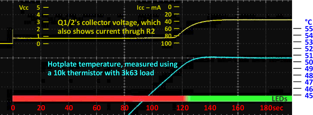

Figure 6 plots its performance when starting from cold, showing the overshoot and recovery. Compare this with Figure 3.
The start-up performance of Figure 5's circuit.
Figure 6. The start-up performance of Figure 5’s circuit.
