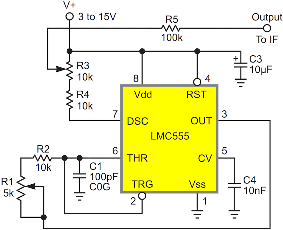

Today’s Design Idea (Figure 1) does a similar job, but takes less space while needing only about half as many components. Also, the parts it does require are easier to source.
This 455 kHz intermediate frequency beat frequency oscillator is tuned by R1. The amplitude of the injected IF signal is adjusted by R3. It works happily with a wide range of supply voltages and so needs no regulator.
Figure 1. This 455 kHz intermediate frequency beat frequency oscillator is tuned by R1. The amplitude

Some basic, mainly older, receivers can’t do that. What to do for them? We can simply tack on a BFO. An add-on BFO works by injecting a low-level signal into the receiver’s IF chain that:
  1. Is manually adjustable to be the correct amplitude that allows the receiver’s existing automatic gain control (AGC) loop to respond to and follow the incoming RF signal normally.
  2. Is tuneable to accurately match and sum with the IF frequency so that, when mixed with the IF signal by the receiver’s final detector, it can recreate the SSB suppressed carrier and modulation audio.
The oscillation frequency is given by the following equation:
where
CS = stray capacitance = ~15 pF
TD = internal 555 delay (See [2]) = ~212 ns
With the component values shown, it’s tunable over 455 kHz ±20%.
The oscillator output is taken from pin 7 rather than 3 to maximize isolation and minimize coupling between the IF chain and BFO oscillation frequency. This is important for audio quality.
The output amplitude is adjusted by R3 over a range of 0 to (V+)/2.
