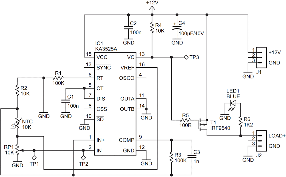

The core element of the circuit in Figure 1 is an SG3525A (KA3525A) pulse-width-modulator chip (IC1). The next key component is a negative temperature coefficient (NTC) thermistor that works as the temperature sensor. The powerful P-channel MOSFET IRF9540 (T1) at the output of the circuit can smoothly drive connected heater loads with current requirements up to 19 A at a 12-Vdc supply. Although not very crucial, a regulated/clean 12-Vdc input is recommended for this circuit. Table 1 shows the bill of materials.

while the 10K trimpot (RP1) sets the duty cycle. Driver outputs of IC1 are grounded so that its VC terminal is switched to ground by the internal totem-pole source transistors on alternate oscillator cycles to drive T1. The NTC thermistor, together with the 10K resistor (R2), forms a potential divider to feed a proportional input to the inverting terminal (Pin 1) of IC1. Note that the internal 5.1-V reference of IC1 (Pin 16) is used to bias this potential divider and the trimpot connected to the non-inverting terminal (Pin 2). The R-C network (R3-C3) provides feedback compensation enough to prevent nasty overshoots and oscillations.

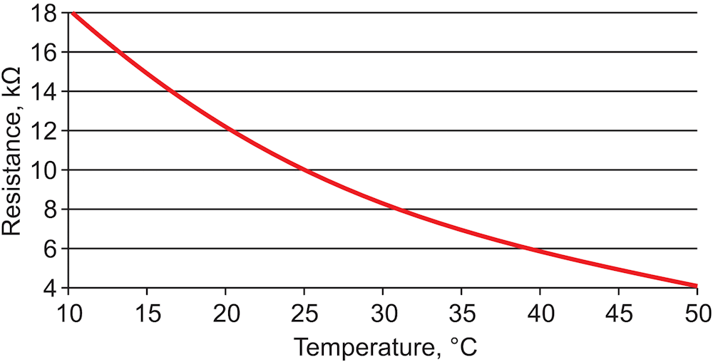

If you want to optimize your heating system, you first must record requisite parameters continuously and precisely. Once you have this data, you can quickly assess the impact of even relatively minor changes. Better understanding of the thermistor’s electrical characteristics also ensures a smooth takeoff in this regard (see Figure 2).

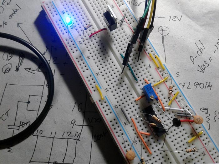

The author tested his breadboarded prototype of the design thoroughly to see whether the practical results matched the theory (see Figure 3) and got the final results as expected.

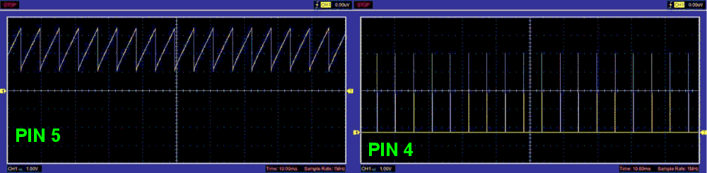

A bit of (boring) theory: The PWM frequency is determined by the R-C components R1 and C1 connected to Pin 6 (RT) and Pin 5 (CT) of IC1. You can monitor the frequency through Pin 4 of IC1. Shown in Figure 4 are two random oscillograms captured when the scope probed at Pin 5 and Pin 4 of IC1.

Pin 1 and Pin 2 of IC1 are the inputs of onboard error amplifier to increase or decrease the duty cycle based on the voltage levels on them. When voltage on Pin 1 is greater than the voltage on Pin 2, duty cycle decreases, and vice versa. If duty cycle is at maximum, output at Pin 13 of IC1 is around 0.6 V, and it’s around 11.4 V (VCC-0.6) if the duty cycle is minimum. The “throttle” control works between these two margins and perpetually adjusts the PWM until the error is zero.

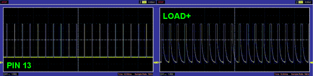

Pin 13 (VC) is, in fact, the supply voltage (4.5–35 V) terminal of the driver stage. Here, VC is used to drive the power MOSFET (single-ended supply mode of the chip) through a 100-Ω protection resistor (R5). Also see the next (again random) oscillograms in Figure 5: scope probed at Pin 13 (TP3) of IC1 and Load+ terminal of J2.
