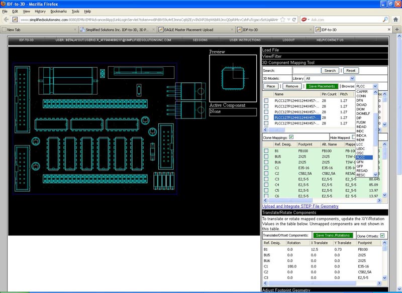

IDF-to-3D interface
IDF-to-3D interface
This tool allows users to export IDF files from EAGLE which they can then import into their MCAD tool of choice for further improvement. IDF files are a first-order 3D model, all components are represented as cubes whose dimensions represent the maximum dimensions of the components on the PCB. For simple cases this might be enough, however, in the general use case the end user would prefer to replace these cubes with more accurate 3D models.
Users can choose to make this replacement manually in their MCAD tool or use the SimplifiedSolutions web interface to do the work for them. The online tool has a large library of vetted 3D models that are already mapped to EAGLE's built-in libraries, so many of your components will be automatically mapped once you upload the file. Any remaining components that aren't mapped can be mapped by users through the intuitive and easy to use interface. Users can also upload their own models and create their own library of preferred models.

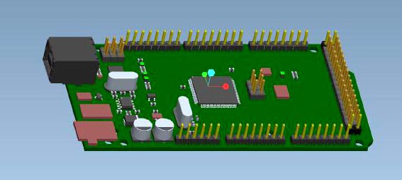

Partially mapped ArduinoMEGA
Partially mapped ArduinoMEGA. Unmapped components appear as brown rectangles.
