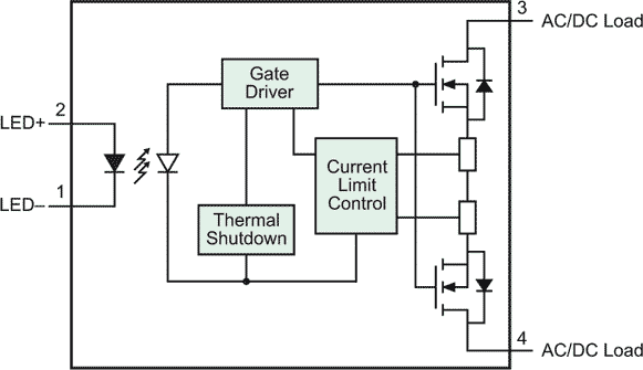

The 230 V CPC1511 is manufactured with an optically isolated control input, and an integrated monolithic die for the output current. Fabricated with ICD’s HVIC SOI technology, the device is an integrated powered driver with active current limiting and thermal shutdown circuitry and Power MOSFET switches. CPC1511 incorporates thermal shutdown circuitry for improved survivability in harsh environments and is designed to pass regulatory voltage surge requirements when provided with appropriate over voltage protection circuitry. This device is designed specifically for harsh AC or DC applications where printed circuit board space is at a premium and additional power supplies are not available. The active current limit and thermal shutdown features offer automatic recovery to the appropriate switch state, as determined by the input control current, once the fault condition is removed. This fault protection circuitry provides excellent robustness in high stress switching environments.
The CPC1511 Block Diagram
The CPC1511 Block Diagram.
