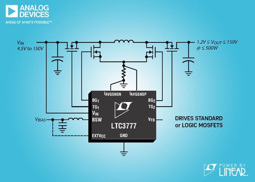

Analog Devices announces the Power by Linear™ LTC3777, a 150 V high efficiency (up to 99%) 4-switch synchronous buckboost DC/DC controller, which operates from input voltages above, below or equal to the regulated output voltage. Its 4.5 V to 150 V input voltage range operates from a high input voltage source or from an input that has high voltage surges, eliminating the need for external surge suppression devices, ideal for transportation, industrial and medical applications.
Analog Devices - LTC3777
To prevent high on-chip power dissipation in high input voltage applications, the LTC3777 integrates a low quiescent current high efficiency switching bias supply for its internal power consumption. The output voltage of the LTC3777 can be set from 1.2 V to 150 V at output currents up to tens of amps, depending on the choice of external components. Output power up to 500 W can be delivered with a single device. Higher powers can be achieved when multiple circuits are configured in parallel. The LTC3777’s powerful 1.5 Ω N-channel MOSFET gate drivers can be adjusted from 6 V to 10 V, enabling the use of logic-level or standard-threshold MOSFETs.

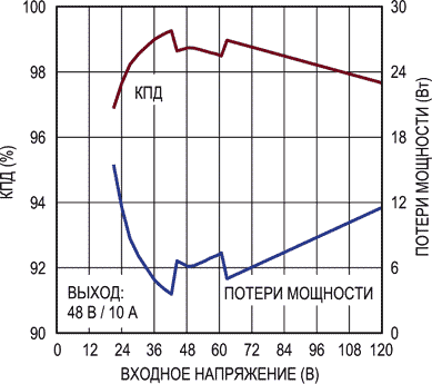

Efficiency and Power Loss vs Input Voltage
Efficiency and Power Loss vs Input Voltage.
