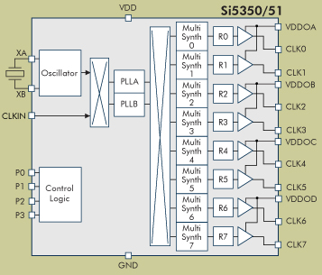

Silicon Laboratories: Si5350/Si5351 Block Diagram
The Si5350/51 generates all system clocks (audio, video, interface and SoC) and can synthesize any combination of eight unique, non-integer-related frequencies up to 133 MHz with 0 ppm frequency error. The Si5350/51 can also simultaneously generate free-running clocks from a crystal input as well as clocks synchronized to a reference clock or analog control voltage input, allowing multiple board-level timing domains to be clocked from a single device.
