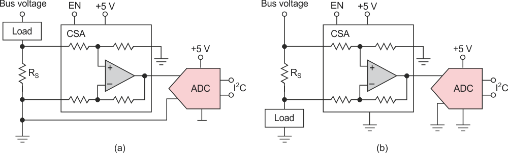

The most common circuits for current determination are given in Figure 2. A sense resistor is connected in series with the supply line carrying the desired current. The CSA is connected across or in shunt with this resistor; the sense resistor is some very low value to avoid introducing an error. The resistor’s precise value is known. The CSA then measures the voltage across the resistor, which in turn allows the current to be calculated via Ohm’s law.
One common current sense application places a sense resistor between the load and ground (a). Another common application has the sense resistor between bus voltage and load (b).
Figure 2. One common current sense application places a sense resistor between the load and ground (a).
Note in Figure 2a that you can connect the sense resistor in the low side of the power line between the load and ground. Alternatively, the sense resistor can be connected between the bus voltage and load (Figure 2b). The low sense resistor value, the precision CSA gain, and its low offset help ensure a highly accurate current measurement. A common destination for the CSA output is an ADC inside a microcontroller or separate chip. The ADC I2C output to an MCU is a value used to make a current-sense decision.
The sense-resistor value is very low so that it doesn’t materially affect the load current. In addition, the voltage across this resistor should be significantly lower than the input offset voltage of the CSA. This ensures good measurement accuracy.
For example, a sense resistor of 0.001 Ω with a load current of 20 A will produce a voltage of 0.02 V or 20 mV. This is usually much higher than the offset. CSA offsets are generally in the range of ±10 to ±150 µV. That sense resistor output voltage will typically be amplified by the CSA gain of 100 to 2 V, which is within range of the ADC.

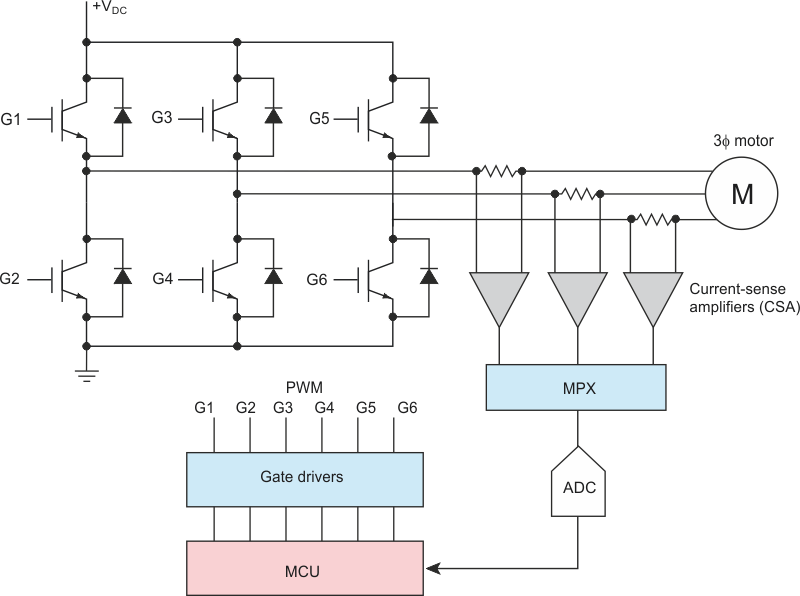

Here, CSAs are monitoring the output of a three-phase IGBT inverter operating an ac motor.
Figure 4. Here, CSAs are monitoring the output of a three-phase IGBT inverter operating an ac motor.
Three-phase motor control is another use case that requires overcurrent monitoring and protection. Operating a motor from a three-phase inverter is an example (Figure 4). The output current from each of the three IGBT half-bridges can be readily monitored with a CSA. The CSA outputs are multiplexed to the ADC that feeds the current measurements back to the MCU.
