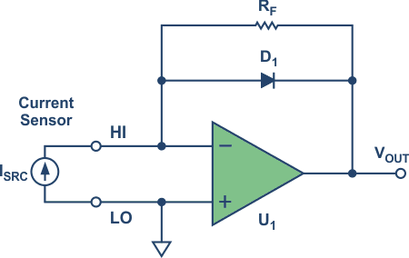

A feedback limiter circuit is needed to avoid the overrange problems. Feedback limiters include a nonlinear feedback element that can handle large amounts of current without high voltages that clip the amplifier output. A simple feedback limiter circuit adds a diode in parallel with the feedback resistor (Figure 1). As the output voltage decreases, the diode (D1) starts to conduct some current from the sensor. The diode’s exponential characteristic allows it to handle very large amounts of sensor current without clipping the amplifier’s output.
TIA with diode limiter.
Figure 1. TIA with diode limiter.
The diode used for the limiter must be selected properly to avoid ruining the circuit performance; this is a challenging task for very high impedance TIA circuits. At low output voltages the diode behaves as a resistor whose resistance depends on the saturation current (IS). This resistance is typically called the diode shunt resistance. The shunt resistance is in parallel with the feedback resistor, so it must be much larger than the feedback resistor to avoid corrupting the transfer function of the TIA. This is difficult because the shunt resistance has an exponential temperature dependence; its value falls by half for every 10 °C increase in temperature. The enormous feedback resistances used in electrometer circuits require careful diode selection. These components require specially designed low leakage diodes or the gate diode of a small discrete JFET. These specialty diodes are usually quite expensive, costing a few dollars each.
The exponential current voltage characteristic of the diode is also the cause of a serious limitation of this circuit. Once the applied voltage (VA) becomes greater than the thermal voltage (kT/q), the exponential characteristic starts to dominate. The linearity of the simple limiter TIA circuit begins to degrade once the output voltage magnitude is greater than the thermal voltage. The thermal voltage is only 26 mV at room temperature, which limits the dynamic range of the circuit considerably.

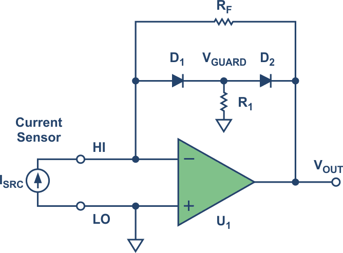

It is possible to reduce the output range limitations of the simple limiter using guarding techniques (Figure 2). The voltage across the limiter diode (D1) is driven to zero with the R1 resistor. This voltage (VGUARD) can be pulled down by the amplifier through the output diode (D2). Feedback limiting starts once VGUARD exceeds the thermal voltage, allowing D1 to conduct. Resistor R1 can be sized to require a considerable amount of current from D2 to create this voltage drop. For example, a 1 kΩ resistor requires 26 µA of diode current to cause a 26 mV drop; this is considerably more than the tens of femtoamperes required by a simple limiter. These large currents ease the requirements of the output diode. Conventional diodes may be used for D2 instead of the specialty diodes required for D1. This circuit allows for adjusting the output range by replacing D2 with a series string of diodes or a single Zener diode. These circuits may also be modified for bidirectional limiting by replacing each diode with the appropriate anti-parallel diodes or back-to-back Zener diodes.
TIA with guarded diode limiter.
Figure 2. TIA with guarded diode limiter.

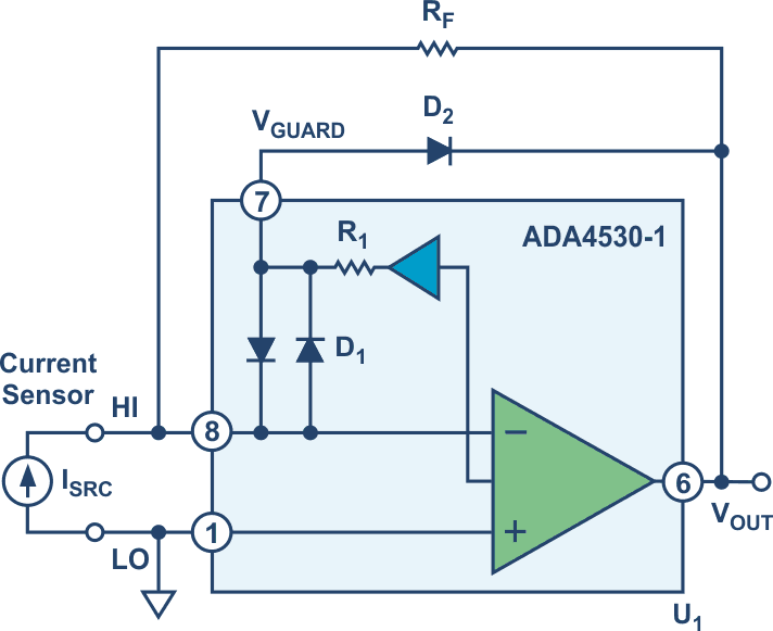

The guarded circuit offers considerable performance improvement compared to the simple diode limiter, but it still depends on the performance of the expensive D1 diode. These price and performance limitations can be eliminated by using an electrometer amplifier that has an internal guard buffer with guard pins. One such amplifier is the ADA4530-1. The internal guard buffer of this amplifier drives the ESD protection diodes with a guard voltage. This guard voltage keeps the input bias current low by eliminating voltage drops across the ESD diodes. These ESD diodes are specially designed to have very low leakage currents.
These on-chip ESD diodes can be used in the guarded limiter circuit (Figure 3). The ESD diodes now serve the function of specialty diode D1. The guard buffer has a 1 kΩ output resistance that functions as resistor R1. The only external component is the output diode, D2. This output diode is connected between the guard pin (Pin 7) and the output voltage. The circuit starts to limit once a thermal voltage is created onto the VGUARD node.
TIA guarded ESD diode limiter.
Figure 3. TIA guarded ESD diode limiter.

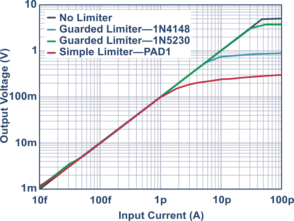

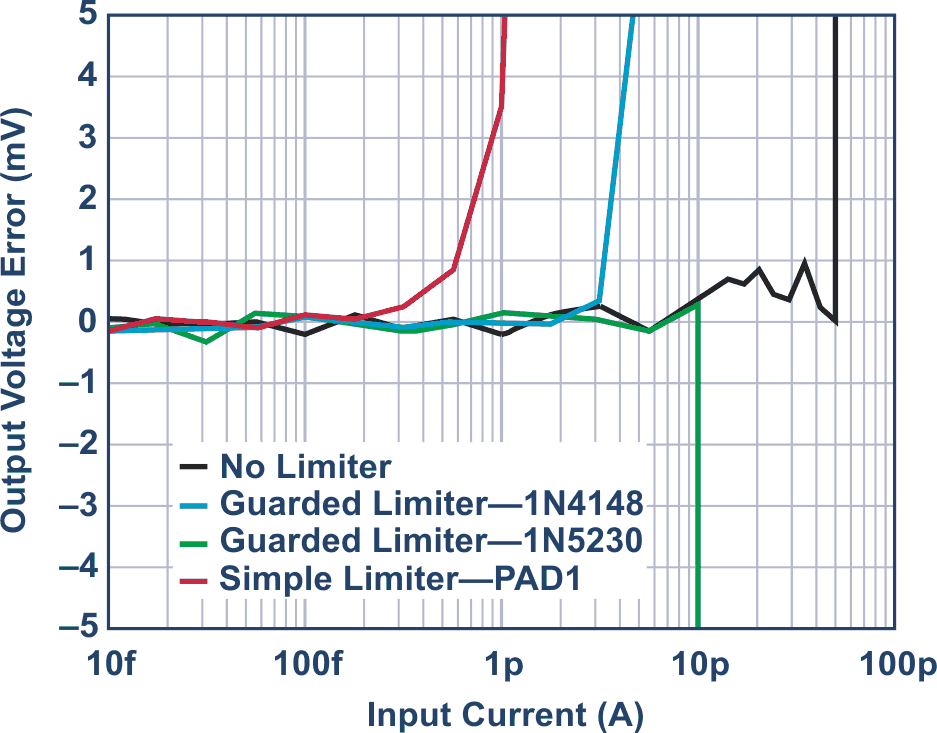

The circuits were evaluated by forcing a test current from an electrometer-grade source measure unit (SMU) (Keithley 6430) into the circuit and measuring the output voltage with a high accuracy DMM (Keysight 3458a). All testing was done at 25 °C with ±5 V power supplies. The test current ranges from 10 fA to 100 pA and the output voltage ranges from 1 mV to 5 V (Figure 5). The linearity is evaluated by plotting the difference between the ideal output voltage and the actual output voltage (Figure 6). The baseline performance is established without any feedback limiter (black curves). Without limiting, the error is less than 1 mV until the amplifier output swings to the power supply rail.
TIA transfer function for measured limiters.
Figure 5. TIA transfer function for measured limiters.
The simple diode limiter circuit was implemented using the low leakage PAD1 diode. The PAD1 diode is a common choice for this kind of application. The performance of the simple limiter (red curves) is identical to the baseline at low test currents. This means that the saturation current resistance of the diode is significantly higher than 100 GΩ (at 25 °C). As expected, the output range is quite limited; the output error exceeds 1 mV at 600 fA of test current. This test current level corresponds to a 60 mV output voltage range.
TIA transfer function error for measured limiters.
Figure 6. TIA transfer function error for measured limiters.
The guarded ESD diode limiter (Figure 3) was evaluated with a low cost 1N4148 output diode (D2). Once again, this guarded limiter performance (blue curves) matches the baseline performance at low test currents. The low leakage ESD diodes integrated on the electrometer amplifier are responsible for this good performance. The 1N4148 simply provides the feedback current. The dynamic range is improved, too, requiring 2.5 pA of test current before the error exceeds 1 mV. This corresponds to a 250 mV output range, which is a 4× improvement.
The flexibility of this circuit was demonstrated by replacing the output diode with a 1N5230 Zener diode. At low test currents, this circuit performs identically to the baseline circuit (green curves). The dynamic range is extended beyond the standard diode. 10 pA of test current is required before the error exceeds 1 mV. This represents a 1 V output range. This circuit begins to limit with Zener currents much less than the specified 1 mA to achieve the 4.7 V nominal breakdown voltage. It is desirable to operate the Zener diode at its rated breakdown for the largest dynamic range with reduced temperature sensitivity. Lower current Zener diodes are available, such as 1N4624. The operating current may also be increased by adding an external resistor between VGUARD and signal ground. A 27 Ω resistor will require 1 mA of Zener current to drop a thermal voltage across the ESD diodes.
