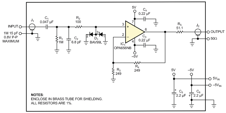

You can assemble the circuit in Figure 1 in an afternoon from readily available and inexpensive components. The circuit's input presents the same characteristics as a bench oscilloscope – a 1-MΩ resistance in parallel with 15 pF of capacitance. You can also use this active probe in place of standard 1-to-1 or 10-to-1 oscilloscope probes, thus extending the design's applicability. The back-to-back silicon diodes in the D1 clamp the input signal to plus or minus one forward-voltage drop, which limits signal excursions you apply to the spectrum analyzer's front end, thus protecting the input mixer from damage due to overloads and ESD. Because most users employ the probe and spectrum analyzer to measure small-amplitude signals and noise, the limited large-signal response does not affect most applications.
High-impedance FET probe extends RF-spectrum analyzer's usable range
Figure 1. Just a handful of parts can help extend a spectrum analyzer’s performance.
This unity-gain probe emulates a standard oscilloscope probe’s 1-MΩ
and 15-pF input characteristics and easily drives 50 Ω loads.

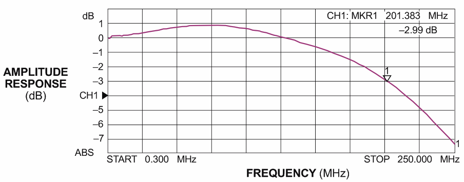

High-performance FET input operational amplifier IC1, a Texas Instruments OPA656, provides a voltage gain of two. This configuration yields a bandwidth of approximately 200 MHz (Figure 2). The OPA656 can drive 50 Ω back-matched loads for a total load of 100 Ω, which results in a 6-dB gain loss for which IC1's gain of two compensates for a net gain of unity. The OPA656 also introduces lower noise and distortion than that of most commercially available, active FET-based probes.
Figure 2. The probe’s measured –3-dB frequency response extends from 10 Hz to 200 MHz
with slightly less than 1-dB passband ripple, which compares favorably with
the ±2-dB response of many commercial active-FET probes.

The probe requires 5 and –5 V at approximately 18 mA each, which you can obtain from an instrument's probe-power connector if available or from a linear supply designed around an ac wall transformer. For best results, use 78L05 and 79L05 voltage regulators to stabilize the supply voltages.
 Standard miniature 50 Ω coaxial cable connects the probe to the measuring instrument. For the flattest frequency response and uniform gain, terminate the probe's output with 50 Ω; the circuit requires no dc-output-blocking capacitor.
