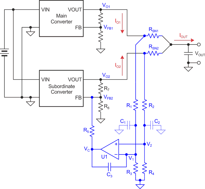

Figure 1 shows a current sharing control scheme in which the subsidiary is forced to deliver the same load current as the main. The sharing control circuit consists of:
  • Operational amplifier (op amp) U1
  • Current-sense resistors RSN1 and RSN2
  • Resistive voltage dividers formed by R1 and R3 and R2 and R4
  • Optional sensing filtering capacitors C1 and C2
  • Compensation capacitor C3 to stabilize the sharing control loop
  • Sharing control resistor R5
Assuming that U1 is an ideal op amp, RSN1 = RSN2, R1 = R2 and R3 = R4. If IO2 becomes greater than IO1 (U1’s output voltage), VC will increase. Consequently, the VFB2 voltage will rise, reducing VO2 and IO2 until IO2 = IO1. Similarly, if IO2 becomes smaller than IO1, the circuit will force VO2 and IO2 to increase in order to reach IO2 = IO1. In short, IO2 will track IO1 in order to achieve balanced current sharing.

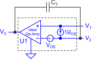

This is how an equivalent circuit of U1 looks like.
Figure 2. This is how an equivalent circuit of U1 looks like.
Let’s analyze the errors caused by U1 (see Figure 2). Assuming that the input offset voltage of U1 is VOS, the offset current is IOS, RSN1 = RSN2, R1 = R2 and R3 = R4. After a simple circuit analysis, you can see the sharing error caused by VOS and IOS, as denoted in Equation 2.
  (2)

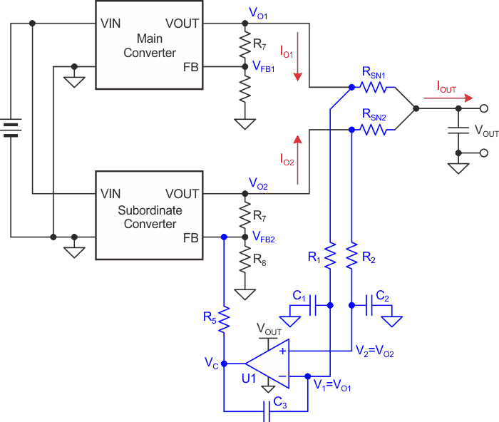

The resistive voltage divider’s voltage step-down ratio should be as small as possible. In the best case, U1 should be an op amp that can take the converter’s output voltage as the bias supply voltage. That’s because you can then remove the bottom resistor of each divider, as shown in Figure 3. Because of high impedance at the U1’s two input pins, the voltage drop across the top resistor of each divider becomes negligible, enabling U1’s two inputs to have direct sensing of the current difference. The direct sensing minimizes the sensing error and sharing error. It also eliminates the static power dissipation in the resistive voltage dividers.
An optimal current-sharing scheme shows when VOUT can directly supply U1.
Figure 3. An optimal current-sharing scheme shows when VOUT can directly supply U1.
The switching ripples on the output voltage rails may affect U1’s performance if not attenuated. Employing C1 and C2 to form low-pass filters with R1 and R2 will reduce the ripple voltage at the inputs of U1. Hence, R1 and R2 must not be 0 Ω. You will have to make a trade-off when selecting the values of R1 and R2 and C1 and C2 such that you can achieve the desired ripple attenuation with minimal cost.

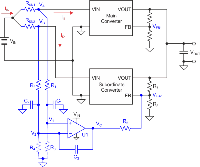

For better performance with parallel boost converters, Figure 4 illustrates a modified current-sharing control scheme. The current-sensing elements are placed on the input side. The operating principle is similar to that of Figure 1, except that this scheme achieves a sharing balance for the input currents of the two converters.
The boost converter current-sharing scheme offers a better performance using a parallel setup.
Figure 4. The boost converter current-sharing scheme offers a better performance using a parallel setup.
Similarly, assuming that U1 is an ideal op amp, RSN1 = RSN2, R1 = R2 and R3 = R4, then the input currents IIN, II1 and II2 satisfy Equation 3.
  (3)
Choosing all six resistors from the E96 series (0.1% tolerance) can limit their effects on the sharing error to <0.6%. The effects of U1’s offset voltage and current are the same as analyzed earlier; namely, Equation 4 calculates the sharing error as follows:
  (4)
Because the input voltage of the boost converter is lower than VOUT, it becomes possible to reduce the required resistive voltage divider’s step-down ratio for a smaller sharing error. If the boost input voltage is smaller than U1’s maximum bias supply voltage rating, U1 can directly take the input voltage, VIN, as its bias supply, and you can remove R3 and R4 to gain the same advantages as discussed earlier.

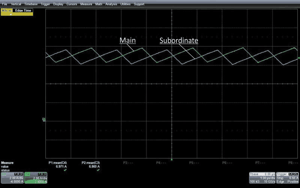

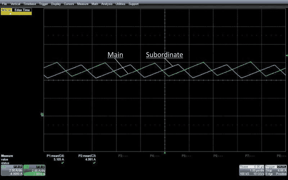

Figure 5 and Figure 6 show two typical experimental results. The input current-sharing errors between the main and subsidiary converters are less than 120 mA, much smaller than the worst-case error of 720 mA.
The result is shown for input current sharing under VIN = 8 V and a 98-W load.
Figure 5. The result is shown for input current sharing under VIN = 8 V and a 98-W load.
The proposed concept was also applied in a reference design of a 9-16 VIN to 50 VOUT, 300-W power supply for typical trolley speakers, which consists of two 150 W LM5155 boost converters in the main and subsidiary configuration.
The result is shown for input current sharing under VIN = 8 V and a 72-W load.
Figure 6. The result is shown for input current sharing under VIN = 8 V and a 72-W load.
