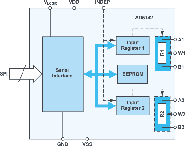

Figure 1 shows a typical diode-stabilized Wien-bridge oscillator with which precise sinusoidal signals in the range of approximately 10 kHz to 200 kHz can be realized at the output (VOUT). Wien-bridge oscillators are characterized by the fact that one bridge path is formed by a band-pass filter and the other by a voltage divider. This example uses – in addition to the ADA4610-1 rail-to-rail precision amplifier – the AD5142 digiPOT, which contains two independently controllable potentiometers, each with a resolution of 256 steps. The programming of the resistance values is done via an SPI, as shown in Figure 2. Alternatively, the AD5142A, which can be controlled via an I2C, can be used. Both variants are available as 10 kΩ or 100 kΩ potentiometers.
Block diagram of the AD5142.
Figure 2. Block diagram of the AD5142.
