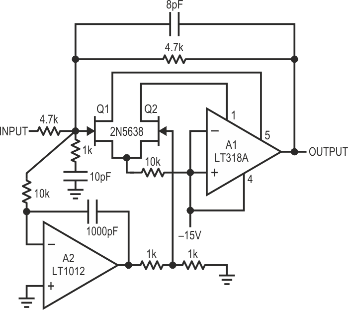

I’m not sure of the exact date and I can’t find the original publication or author (perhaps some reader will be able to locate that), but the most memorable design idea that I ever saw had to do with bypassing the input stage of an IC op-amp with a couple of JFET’s making a kind of Frankenstein hybrid – discrete, IC amplifier (Figure 2). As I recall, the idea dated to the mid-1980s, give or take a decade.
My favorite design idea drawn from memory. The cleverness of using the LM318 for all the backend circuitry along with a user selectable input stage just had universal appeal for me and others as it was used many more times in the coming years.
Figure 2. My favorite design idea drawn from memory. The cleverness of using the LM318 for all
This was a perfect combination in my mind, the ability to use whatever front end you wanted with the simplification of all the output stages by using the rest of the LM318s internals.
I used this concept once or twice and in some test fixtures because it was fun and the National Semiconductor LM318 was a very capable op-amp for its time with settling times to the 10-bit region in less than a microsecond. I was also familiar with the 2N5912, which was a low-noise, low-capacitance dual JFET in a TO-100 package, so I used that in my implementations [4]. We bought that transistor from National Semiconductor also, so instead of making one sale, National Semiconductor made two sales from that design idea. They should have given the original author a commission.

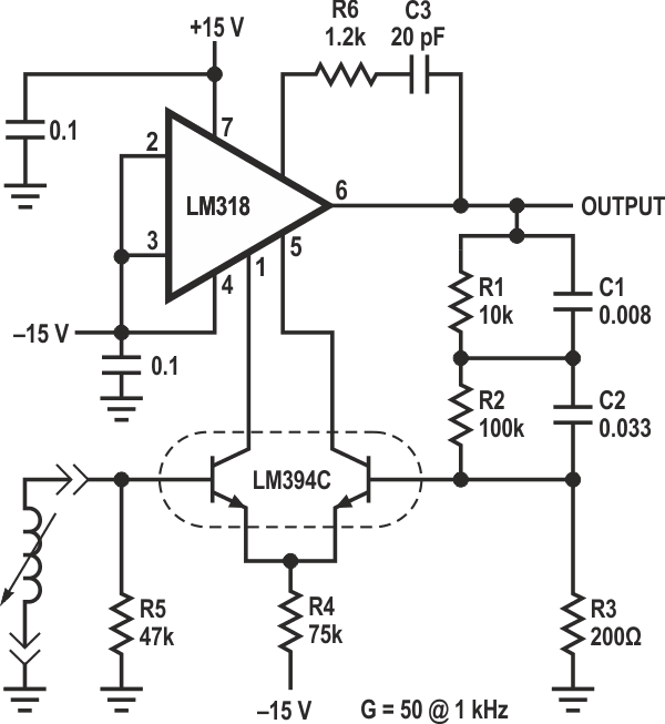

While I have no idea about who invented this first, the basic idea spread all over the place. In 1992 National Semiconductor published application note 299: “Audio Applications of Linear Integrated Circuits” [4]. This application note contained an audio preamplifier that used the LM394 NPN super matched pair and an LM318 to make a low-noise phonograph preamp (Figure 3).
National Semiconductor used their LM394 Super matched pair as the input stage for their take on the design idea.
Figure 3. National Semiconductor used their LM394 Super matched pair
Then, in 1986, Linear Technology published Jim Williams’ take on the idea in application note 21 [5]. There, Jim used the dual FET idea and, where I used to match the JFETs for drift, Jim used a low drift amplifier in a Goldberg topology [6, 7] to zero the drift of the added JFETs (Figure 4).
Jim Williams' take on the design idea circa 1986. Here Jim extended the idea to include low drift as well using the Goldberg topology.
Figure 4. Jim Williams’ take on the design idea circa 1986. Here Jim extended
The bypass the op-amp front end design idea concept shows up in conjunction with other op-amps as well, like the NE5534 classic audio op-amp. This was a universally popular concept for its time and caught many an eye besides my own.
