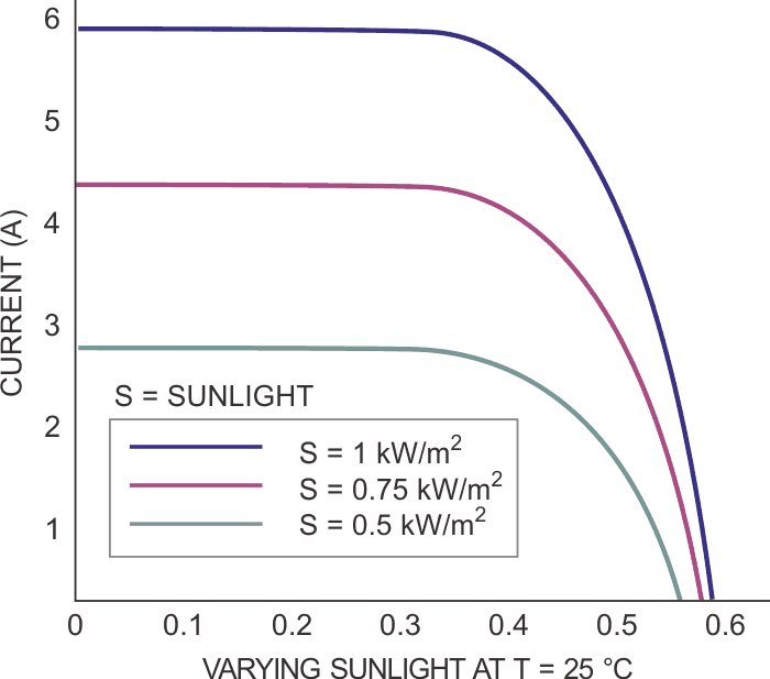

Solar or photovoltaic panels comprise multiple solar cells that connect in series. An ideal solar cell appears as a current source that connects in parallel with a rectifying diode. The photovoltaic current, IPH, depends on the sunlight falling on the solar cell. In the dark, a solar cell is simply a diode. A solar cell residing in shade has limited current-generating and -carrying capability, resulting in limited current-carrying ability for the entire solar panel. The current-output ability of a solar cell falls with a reduction in sunlight (Figure 1).
A solar cell's current output decreases with a reduction in sunlight.
Figure 1. A solar cell’s current output decreases with a reduction in sunlight.

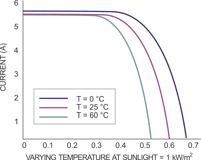

Figure 2 shows the effect of temperature on a solar cell’s output voltage; that is, solar-cell output voltage decreases with an increase in temperature. This design uses a solar panel comprising a series of solar cells to charge a lead-acid battery when the solar panel is operating at the maximum power point. A number of design steps are necessary to ensure that the cell operates continuously at the “knee” of the IV curve, thus providing maximum power to the load (figures 1 and 2).
A solar cell's output voltage decreases with an increase in temperature.
Figure 2. A solar cell’s output voltage decreases with an increase in temperature.

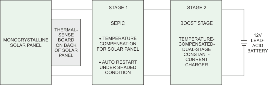

The design in Figure 3 uses an 18-cell, 3 W SunWize Technologies SC3-6V solar panel as the input source. The design comprises one stage that monitors the solar-panel voltages using a SEPIC (single-ended-primary- inductor-converter) topology that employs a LM5001 controller. The LM5001 provides the output voltage that tracks the solar panel’s output voltage over the temperature range. A simple, cost-effective thermal-monitor circuit using a string of BAT54 diodes tracks the solar panel’s voltage over a temperature range of 25 to 100 °C.
The solar charger system uses an 18-cell, 3 W solar panel as the input source. The system comprises two stages, in which the first stage monitors the solar panel's voltages using a SEPIC topology and provides the output voltage, which tracks the input of the solar panel's voltage over the temperature range.
Figure 3. The solar charger system uses an 18-cell, 3 W solar panel as the input source. The system comprises two stages,
in which the first stage monitors the solar panel’s voltages using a SEPIC topology and provides the output voltage,
which tracks the input of the solar panel’s voltage over the temperature range.
The second stage of the design takes the output of the first stage and boosts the input voltage to a nominal 13.3 V at 25 °C and 14.4 V at 100 °C. The second stage is configured as a constant-current controller to charge the 12 V lead-acid battery that matches the optimum charge technique for a lead-acid battery.

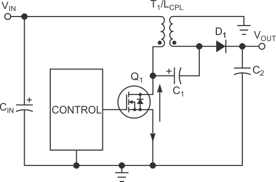

Replacing inductor L2 with a transformer yields an isolated version of a SEPIC. Using a coupled inductor – that is, a 1-to-1 transformer – in place of L1 and L2 makes the design more cost-effective and allows you to replace inductors L1 and L2 with one magnetic element. You can then redraw the schematic (Figure 5). Turning on Q1 holds the positive C1 terminal that connects to the drain of Q1 at ground level, and 1-to-1 transformer T1 induces a voltage equal to the input voltage at the junction of D1 and C1. Thus, the voltage across capacitor C1 equals the input voltage. The SEPIC can provide an output voltage that is greater than or less than the input voltage, according to the follow equation:
where VOUT is the output voltage, VIN is the input voltage, and D is the duty cycle of the main FET, Q1.
Replacing the inductor L2 of Figure 4 yields an isolated SEPIC.
Figure 5. Replacing the inductor L2 of Figure 4 yields an isolated SEPIC.

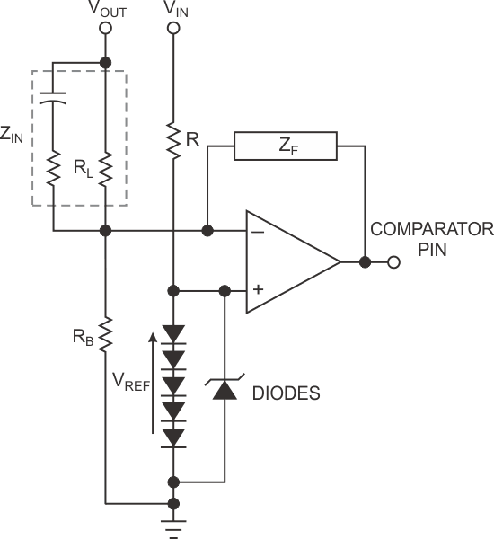

By changing the value of RB in Figure 7 to adjust the voltage divider in the first stage of the SEPIC, you can adjust the SEPIC voltage’s setpoint to accommodate different solar-panel voltages. You can adjust a resistor divider comprising RT and RB to match the SEPIC’s reference voltage, typically 1.34 V at 25 °C, which the thermal board generates. A string of diodes generates a reference voltage that varies with temperature, thus providing temperature compensation to the design. The output of the first stage tracks the solar panel’s voltage and adjusts for varying temperature. It is critical that the reference circuit comprising the string of diodes be close to the hot spot to track the temperature variation.
Changing the value of RB adjusts the SEPIC voltage's setpoint to accommodate different solar panels' voltages. You can adjust a resistor divider comprising RT and RB to match the SEPIC's reference voltage, typically 1.34 V at 25 °C, which a thermal board generates.
Figure 7. Changing the value of RB adjusts the SEPIC voltage’s setpoint to accommodate
different solar panels’ voltages. You can adjust a resistor divider comprising RT

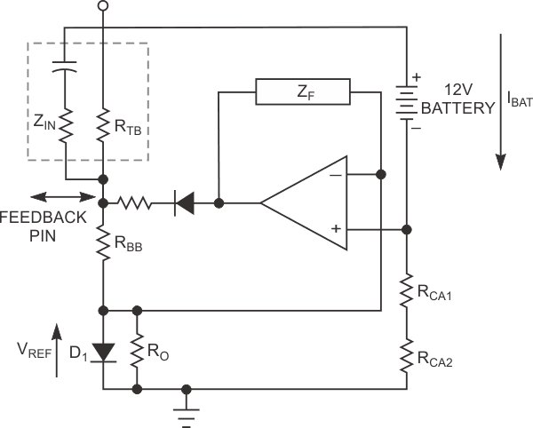

The second stage of the design comprises a SEPIC that operates in boost mode with constant current-charge control. This SEPIC charges the 12 V battery (Figure 8). Adjusting the value of RCA1 and RCA2 allows the adjustment of the battery-charging current to meet customer needs. You set the battery-charging current, IBAT, by dividing the reference voltage, which diode D1 – VD1’s forward drop sets; a typical value is 0.183 V at 25 °C. You then divide the result by RCA1 + RCA2. Because the reference voltage’s drop, due to D1, varies with temperature, this calculation accounts for the battery’s charging-current variation over temperature:
You set the two-stage current charging by bypassing the RCA2 current-set resistor once the temperature reaches 60 °C. Adjusting the RTB and RBB resistor values in Figure 8 sets the second-stage converter’s boost voltage.
The second stage comprises a SEPIC that operates in boost mode with constant current-charge control and charges the 12 V battery.
Figure 8. The second stage comprises a SEPIC that operates in boost mode with constant

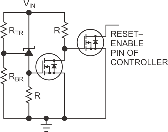

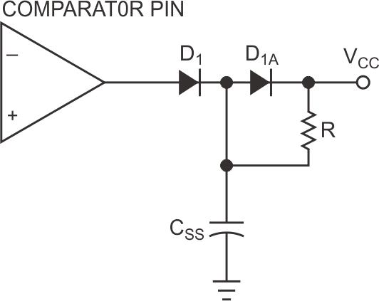

When the solar panel is in shade, its current capability decreases, resulting in overloading of the solar panel because of the fixed load on the solar panel; battery charging requires this fixed load. This overloading reduces the solar panel’s output voltage. The RBR/RTR divider that connects to the LM4041 in the first stage senses the solar panel’s output voltage, which initiates a restart mode by disabling the second stage of the circuit by pulling down on the enable pin of LM5001 (Figure 9).
The RBR/RTR divider that connects to the LM4041 in the first stage senses the solar panel's output voltage, which initiates a restart mode by disabling the second stage of the circuit by pulling down on the enable pin of LM5001.
Figure 9. The RBR/RTR divider that connects to the LM4041 in the first stage senses
Once you remove the fault condition that shading causes, the solar panel’s voltage increases and allows the circuit to operate in the normal condition. The RBR/RTR divider senses when this voltage falls due to shading and rises again. The divider disables the second stage by pulling down the LM5001’s enable pin.

If you accidentally disconnect the thermal board that houses both diode D1 in Figure 8 and diode string VREF in Figure 7, the boost output voltage will clamp to a fixed output voltage, thus preventing the output voltage from exceeding a fixed, predetermined level and preventing any damage to the battery.
The following equation determines the maximum boost voltage in case of an accidental disconnection of the thermal board:
where the LM5001’s reference voltage is nominally 1.26 V, ensuring that the battery does not exceed its overvoltage limit.

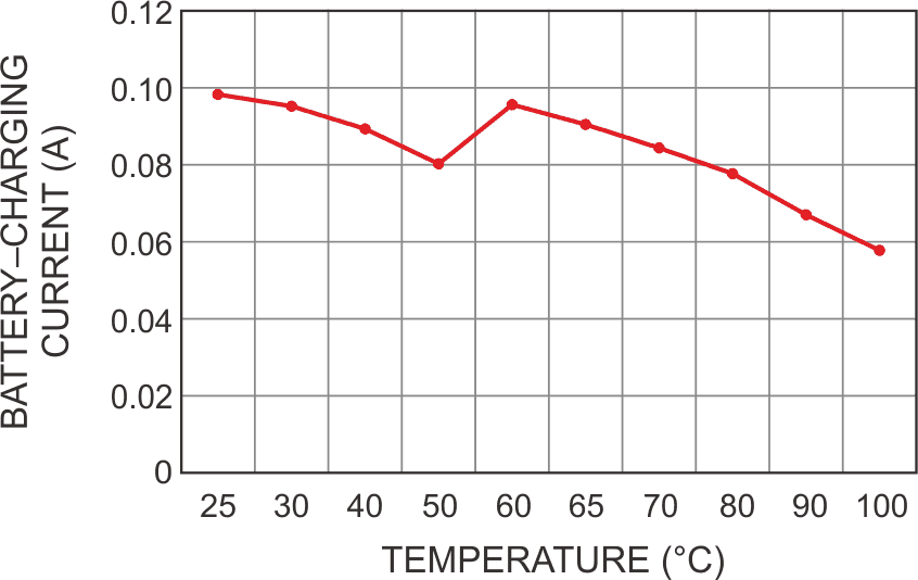

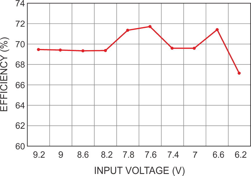

Test data on the unit over temperature in the lab using a dc source shows the performance of the two-stage solar-charger circuit. Figure 10 shows the battery-charging current versus temperature, and Figure 11 shows the voltage from the solar panel versus the overall charger efficiency. Figure 12 shows the typical waveforms of the circuit, highlighting the battery-charging current, the output ripple, and the switch node’s waveform.
Efficiency falls off rapidly when the input voltage from the solar panel falls below 6.5 V.
Figure 11. Efficiency falls off rapidly when the input voltage from the solar
At 60 °C, the circuit moves into the second-stage current regulation, in which the current to the battery increases. The bolded text in column 7 in Table 1 highlights this transition point. This transition point provides optimum efficiency for the application because 60 °C is the normal operating temperature for the application.
