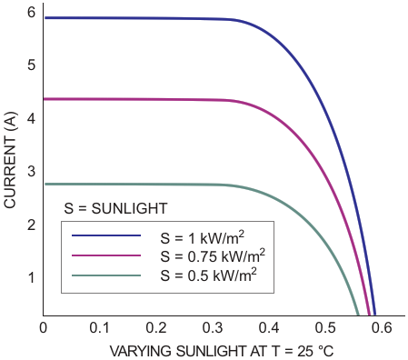

A solar cell's current output decreases with a reduction in sunlight

Solar panel powers two-stage lead-acid battery charger
Figure 1. A solar cell's current output decreases with a reduction in sunlight
