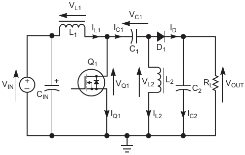

A SEPIC is a dc/dc topology that allows the output voltage to be greater than, less than, or equal to the input voltage

Figure 3. The solar charger system uses an 18-cell, 3 W solar panel as the input source. The system comprises two stages, in which the first stage monitors the solar panel's voltages using a SEPIC topology and provides the output voltage, which tracks the input of
Figure 4. A SEPIC is a dc/dc topology that allows the output voltage to be greater than, less than, or equal to the input voltage
