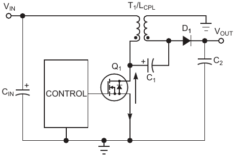

Figure 4. A SEPIC is a dc/dc topology that allows the output voltage to be greater than, less than, or equal to the input voltage
Figure 5. Replacing the inductor L
2
of Figure 4 yields an isolated SEPIC
