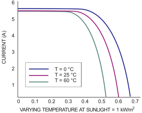

A solar cell's output voltage decreases with an increase in temperature

Figure 2. A solar cell's output voltage decreases with an increase in temperature
