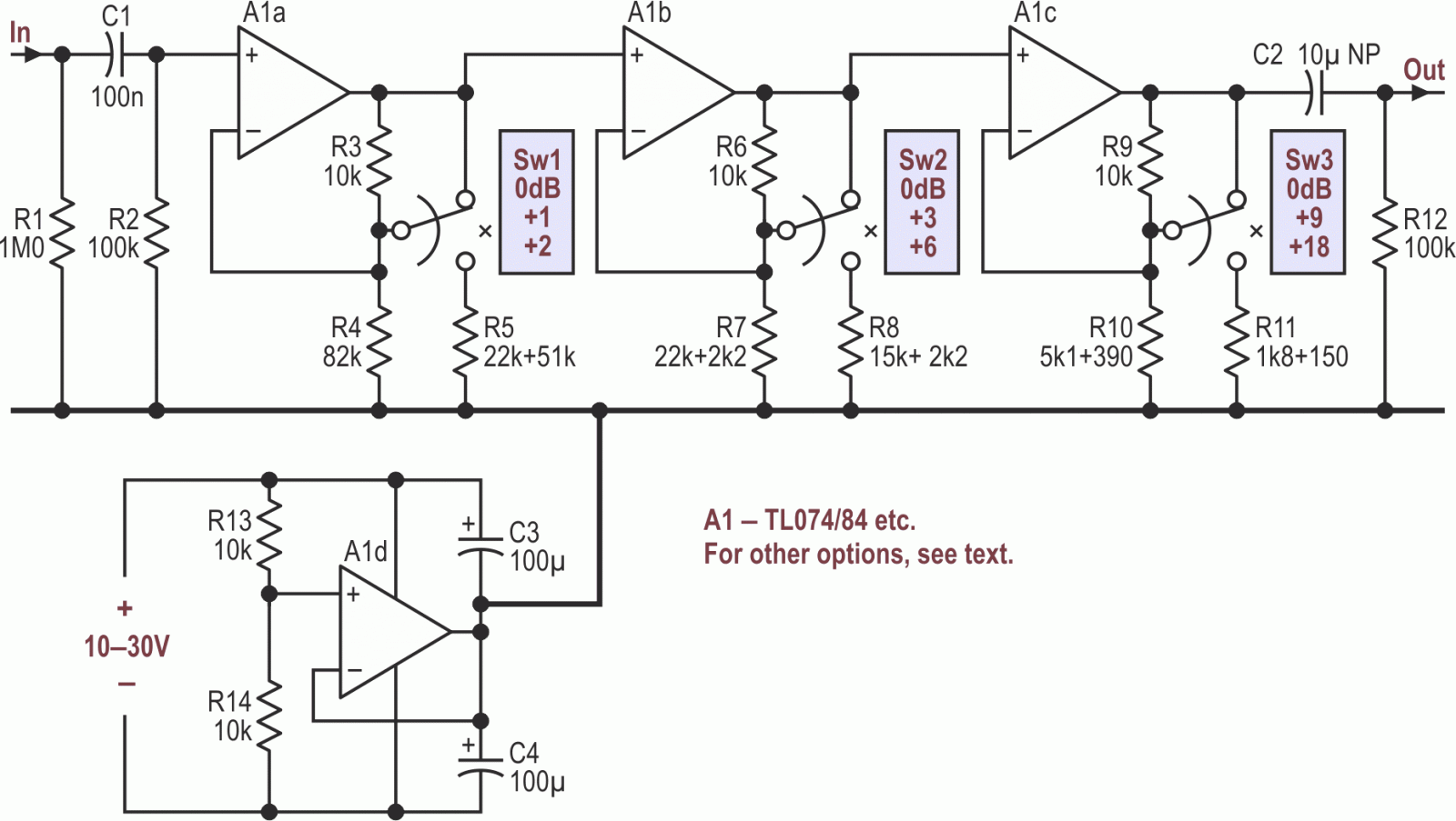

That’s the basic idea, but it’s always more satisfying to convert such ideas into something useful. Figure 2 illustrates just that: an audio gain-box whose amplification is switched in a ternary sequence to give precise 1-dB steps from 0 to +26 dBs. As built, it makes a useful bit of lab kit.
| Figure 2. | Ternary switching over three stages gives 0–26 dB gain in precise 1-dB steps. |
Three gain stages are concatenated, each having its own switch. C1 and C2 isolate any DC, and R1 and R12 are “anti-click” resistors, ensuring that there’s no stray voltage on the input or output when something gets plugged in. A1d is the usual rail-splitter, allowing use on a single, isolated supply.
The op-amps are shown as common-or-garden TL074/084s. For lower noise and distortion, (a pair of) LM4562s would be better, though they take a lot more current. With a 5-V supply, the MCP6024 is a good choice. For stereo use, just duplicate almost everything and use double-pole switches.
All resistor values are E12/24 for convenience. The resistor combinations shown are much closer to the ideal, calculated values than the assumed 1% tolerance of actual parts, and give a better match than E96s would in the same positions.

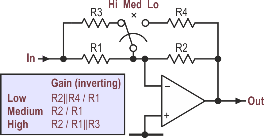

Figure 1 showed the non-inverting version, and Figure 3 now employs the idea in an inverting configuration. Beware of noise pick-up at the virtual-earth point, the op-amp’s inverting input.

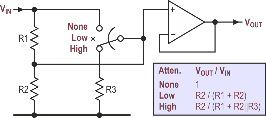

The same scheme can also be used to make an attenuator, and a basic stage is sketched in Figure 4. Its input resistance changes depending on the switch setting, so an input buffer is probably necessary; buffering between stages and of the output certainly is.

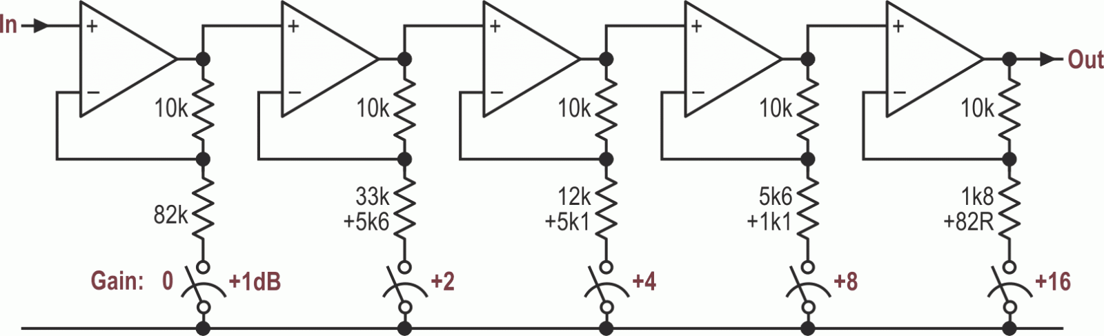

You’ve probably been wondering, “What’s wrong with binary switching?” Not a lot, except that it uses more op-amps and more switches while being rather obvious and hence less fun.
| Figure 5. | Binary switching of gain from 0 to +31 dB, using power-of-2 steps. Again, the theoretical resistor values are much closer to the ideal than their actual 1% tolerances. |
Anyway, here (Figure 5) is a good basic circuit to do just that.
