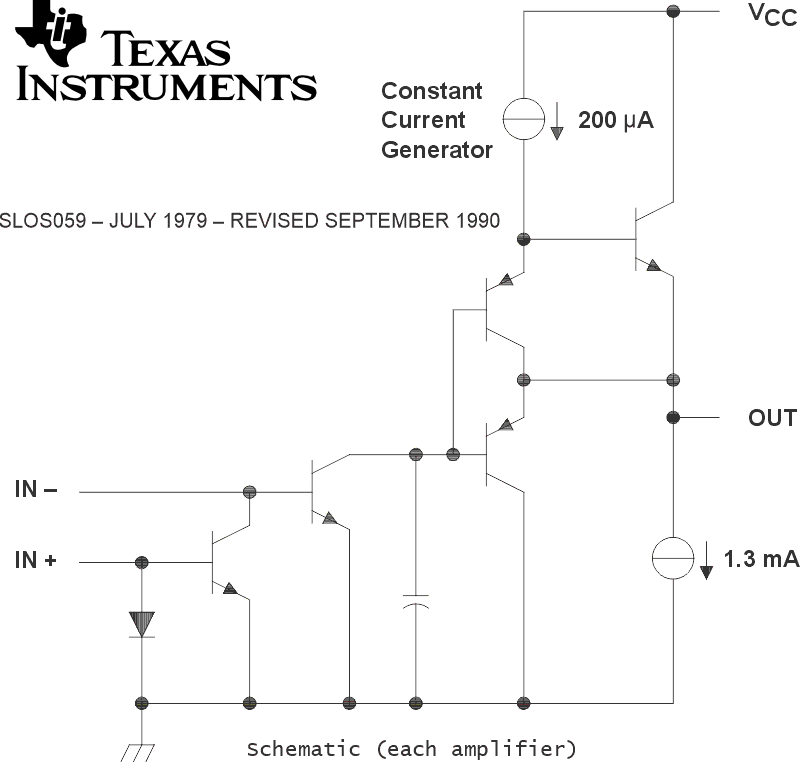

As shown in the LM2900 IC equivalent circuit in Figure 1, the internal architecture is refreshingly straightforward. The most striking departure from a conventional op-amp – typically centered around a voltage-mode differential pair – lies in the input stage. Rather than employing the familiar long-tailed pair, this Norton amplifier features a current mirror followed by a common-emitter amplifier.
Equivalent circuit highlights the minimalist internal structure of the LM2900 Norton amplifier IC.
Figure 1. Equivalent circuit highlights the minimalist internal structure of the LM2900

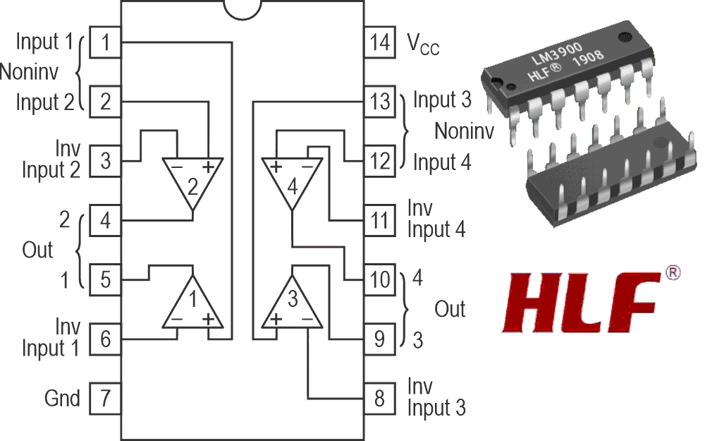

These devices have been around for decades, and they clearly continue to intrigue analog enthusiasts. Just recently, I picked up a batch of LM3900-HLF ICs from an online seller (FIgure 2). The LM3900-HLF appears to be a Chinese-sourced variant of the classic LM3900 – a quad Norton operational amplifier recognized for its current-differencing input and quietly unconventional topology. These low-cost quads are now widely used across analog systems, especially in medium-frequency and single-supply AC applications.
Pin connections of the LM3900-HLF support easy adoption in practical circuits.
Figure 2. Pin connections of the LM3900-HLF support easy adoption in practical circuits.

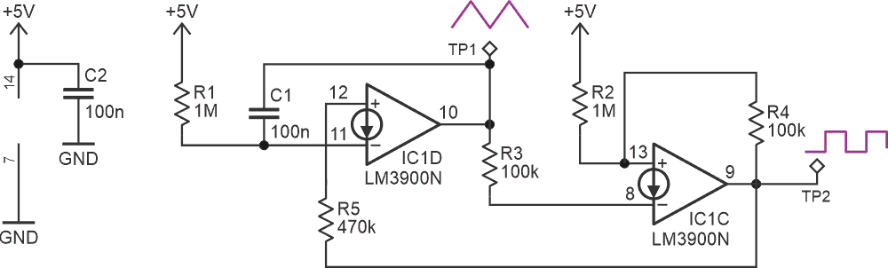

There is not much more to say about Norton amplifiers for now, so we will wrap up this slightly off-the-beaten-path blog post here. As a parting gift, here is a practical LM3900-based circuit – just enough to satisfy those who find joy in the scent of solder smoke (Figure 3).
Bring this LM3900-based triangle/square waveform generator circuit to life and trace its quiet Norton-style elegance.
Figure 3. Bring this LM3900-based triangle/square waveform generator circuit to life and trace its quiet Norton-style elegance.
Triangle waveforms are usually generated by an integrator, which receives first a positive DC input voltage, and then a negative DC input voltage. The LM3900 Norton amplifier facilitates this operation within systems powered by a single supply voltage, thanks to the current mirror present at its non-inverting (+) input. This feature enables triangle waveform generation without the need for a negative DC input.
In the above schematic diagram, amplifier IC1D functions as an integrator. It first operates with the current through R1 to generate a negative output voltage slope. When the IC1C amplifier – the Schmitt trigger – switches high, the current through R5 causes the output voltage to rise.
For optimal waveform symmetry, R1 should be set to twice the value of R5 (and here R1 = 1 MΩ and R5 = 470 kΩ, which is close enough). Note that the Schmitt circuit also provides a square wave output at the same frequency.
