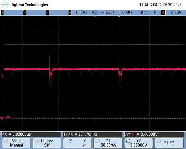

Neglecting the boost cap
Designers do not have a perceived advantage to leaving out the boost capacitor, but may do so to reduce BOM size and cost, or may simply forget to include these components, without realizing the downsides to this decision – the boost capacitor is necessary to help the chip provide enough voltage to the gate of the top FET to fully turn on, as seen in Figure 2.
Switch node without boost capacitor.
Figure 2. Switch node without boost capacitor.
If the top FET does not fully turn on, the device will not be able to regulate the output voltage. The FET will operate in its linear region, dissipating a large amount of power and heating up the chip.
To fix this, designers must add the boost capacitor. If designers are unsure about what value to add, they should choose a value in the data sheet example closest to their application. If a device needs a boost capacitor, forgetting to add it will lead to failure of the SMPS. Adding the boost capacitor will allow the top gate driver to have enough drive strength to operate the FET in its saturation region, allowing it to act as a switch, and provide the full input voltage to the SW node. This can be seen in Figure 3.
Switch node with boost capacitor.
Figure 3. Switch node with boost capacitor.

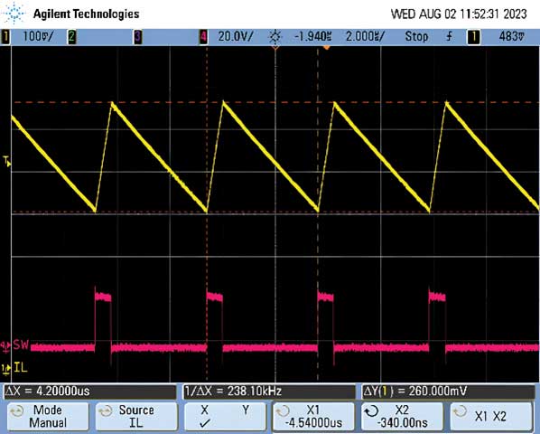

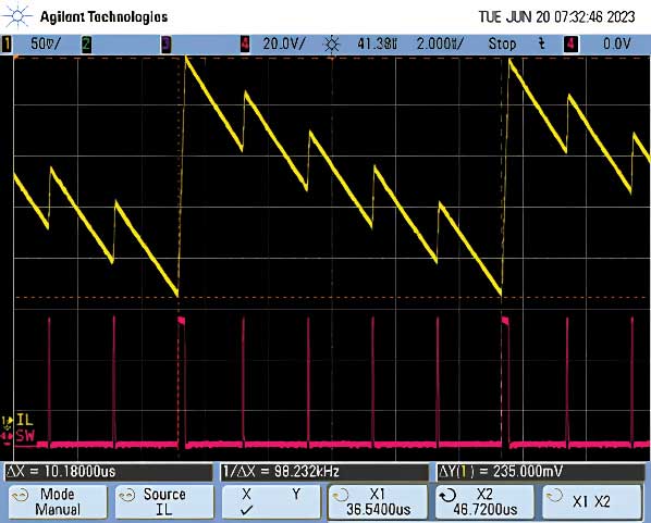

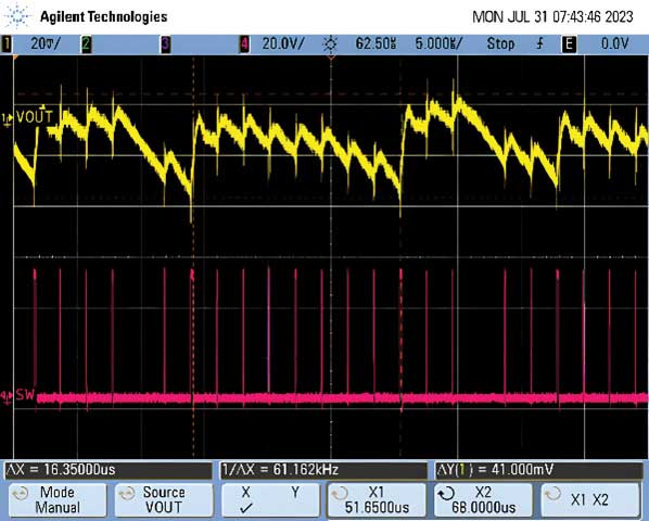

When the on-time is forced below its minimum value, the inductor current will discharge faster than it charges in one period. As a new period begins, the starting point is lower than the previous cycles’ starting point, which is known as current drooping. Eventually, both the current and output voltage droop so low that the device internally generates a bigger duty cycle (with a higher on-time) to regulate the output voltage, as demonstrated in Figure 4.
Violated minimum on-time current waveform.
Figure 4. Violated minimum on-time current waveform.

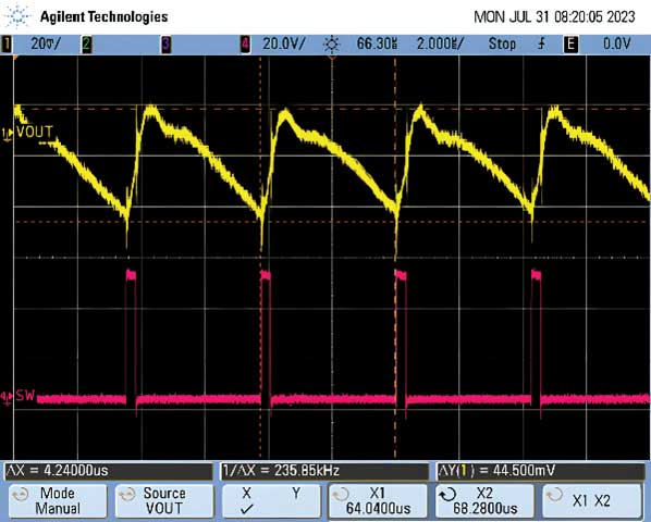

This droop of the inductor current ripple manifests itself in the converter’s output voltage as well. The output voltage ripple becomes noisier, which could affect sensitive loads and worsen EMI performance. This effect can be seen in Figure 5.
Violated minimum on-time output waveform.
Figure 5. Violated minimum on-time output waveform.

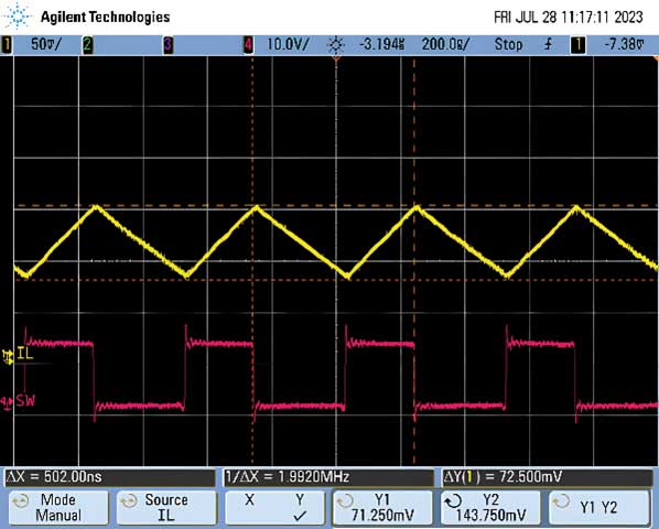

This issue has an easy solution. Since the on-time is influenced primarily by the switching frequency, designers can rectify the issue by decreasing the frequency. This comes at the expense of needing larger power stage components, primarily a larger inductor. The improved functionality of the buck converter can be seen in the consistent on-time between periods, as well as the stable current ripple in Figure 6 and the stable output ripple in Figure 7.
Stable current ripple.
Figure 6. Stable current ripple.

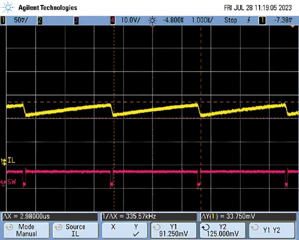

If the duty cycle exceeds the maximum value, the SMPS will fold back the frequency that it was configured for to avoid violating the minimum off-time spec. This can be seen in Figure 8. The device was initially configured for 2 MHz.
Stable output ripple.
Figure 8. Violated minimum off-time current waveform. Frequency folds back to 335 kHz.

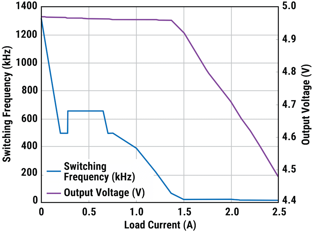

In Figure 9, the device is shown to fold back the frequency to maintain a constant output voltage as the load increases. The device operated in DCM up until about 0.28 A, which is why the frequency drops to about 495 kHz before rising back up to 657 kHz. The device can maintain proper operation running at 657 kHz until drawing a load of 0.7 A. The frequency decreases to maintain the proper output voltage until the load draws around 1.4 A. When this happens, the device cannot decrease the frequency below 100 kHz (the minimum specified feedback frequency for the part) while maintaining the output voltage, so the output voltage begins to droop.
Стабилизация по току нагрузки и прогрессирующее снижение частоты. По мере увеличения нагрузки частота снижается, чтобы поддерживать заданный уровень выходного напряжения.
Figure 9. Load regulation and foldback frequency. As the load increases, the frequency
folds back to maintain a regulated output voltage.

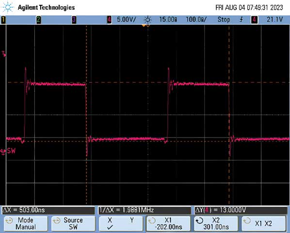

The solution for this issue is not as simple as the minimum on-time violation. Since designers often have a set input voltage and set output voltage, the duty cycle cannot be changed to allow for a longer off-time. If they can provide a larger input voltage, the part will operate at the set frequency since the smaller duty cycle will prevent the part from violating the minimum off-time. This can be seen in Figure 10, where the part operates at its set 2 MHz.
Unviolated minimum off-time current waveform. Set frequency is 2 MHz.
Figure 10. Unviolated minimum off-time current waveform. Set frequency is 2 MHz.
In contrast to the minimum on-time, lowering the frequency will only work up to a certain load. If the designer cannot sufficiently lower the switching frequency to prevent violating the minimum off-time spec, the best course of action is to choose a different part that can handle higher duty cycles and shorter on-times.
