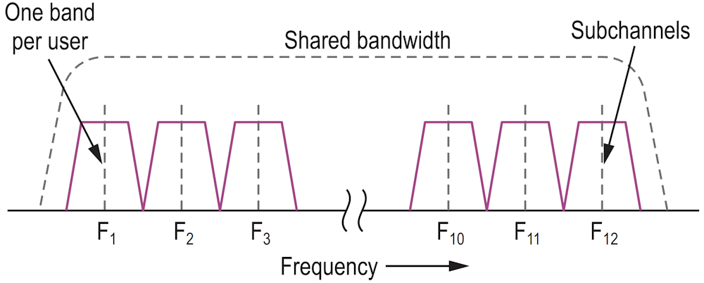

FDMA is the process of dividing one channel or bandwidth into multiple individual bands, each for use by a single user (Fig. 1). Each individual band or channel is wide enough to accommodate the signal spectra of the transmissions to be propagated. The data to be transmitted is modulated on to each subcarrier, and all of them are linearly mixed together.
FDMA divides the shared medium bandwidth into individual channels. Subcarriers modulated by the information to be transmitted occupy each subchannel.
Figure 1. FDMA divides the shared medium bandwidth into individual channels. Subcarriers

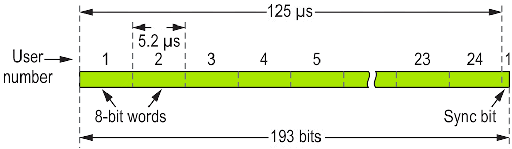

A good example is the widely used T1 transmission system, which has been used for years in the telecom industry. T1 lines carry up to 24 individual voice telephone calls on a single line (Fig. 2). Each voice signal usually covers 300 Hz to 3000 Hz and is digitized at an 8-kHz rate, which is just a bit more than the minimal Nyquist rate of two times the highest-frequency component needed to retain all the analog content.
This T1 digital telephony frame illustrates TDM and TDMA. Each time slot is allocated to one user. The high data rate makes the user unaware of the lack of simultaneity.
Figure 2. This T1 digital telephony frame illustrates TDM and TDMA. Each time slot is allocated
The digitized voice appears as individual serial bytes that occur at a 64-kHz rate, and 24 of these bytes are interleaved, producing one T1 frame of data. The frame occurs at a 1.536-MHz rate (24 by 64 kHz) for a total of 192 bits. A single synchronizing bit is added for timing purposes for an overall data rate of 1.544 Mbits/s. At the receiving end, the individual voice bytes are recovered at the 64-kHz rate and passed through a digital-to-analog converter (DAC) that reproduces the analog voice.

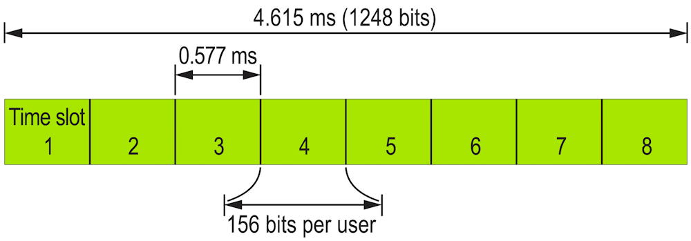

The basic GSM (Global System of Mobile Communications) cellular phone system is TDMA-based. It divides up the radio spectrum into 200-kHz bands and then uses time division techniques to put eight voice calls into one channel. Figure 3 shows one frame of a GSM TDMA signal. The eight time slots can be voice signals or data such as texts or e-mails. The frame is transmitted at a 270-kbit/s rate using Gaussian minimum shift keying (GMSK), which is a form of frequency shift keying (FSK) modulation.
FDMA разделяет полосу общей среды на отдельные подканалы. Каждый подканал занимает поднесущая, модулированная передаваемой информацией.
Figure 3. This GSM digital cellular method shows how up to eight users can share a 200-kHz
channel in different time slots within a frame of 1248 bits

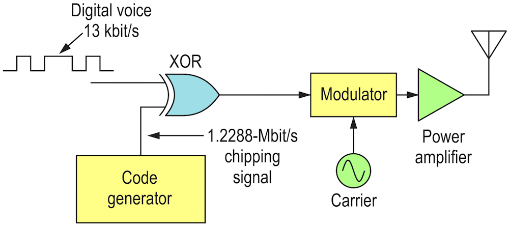

CDMA is another pure digital technique. It is also known as spread spectrum because it takes the digitized version of an analog signal and spreads it out over a wider bandwidth at a lower power level. This method is called direct sequence spread spectrum (DSSS) as well (Fig. 4). The digitized and compressed voice signal in serial data form is spread by processing it in an XOR circuit along with a chipping signal at a much higher frequency. In the CDMA IS-95 standard, a 1.2288-Mbit/s chipping signal spreads the digitized compressed voice at 13 kbits/s.
Spread spectrum is the technique of CDMA. The compressed and digitized voice signal is processed in an XOR logic circuit along with a higher-frequency coded chipping signal. The result is that the digital voice is spread over a much wider bandwidth that can be shared with other users using different codes.
Figure 4. Spread spectrum is the technique of CDMA. The compressed and digitized voice
The chipping signal is derived from a pseudorandom code generator that assigns a unique code to each user of the channel. This code spreads the voice signal over a bandwidth of 1.25 MHz. The resulting signal is at a low power level and appears more like noise. Many such signals can occupy the same channel simultaneously. For example, using 64 unique chipping codes allows up to 64 users to occupy the same 1.25-MHz channel at the same time. At the receiver, a correlating circuit finds and identifies a specific caller’s code and recovers it.

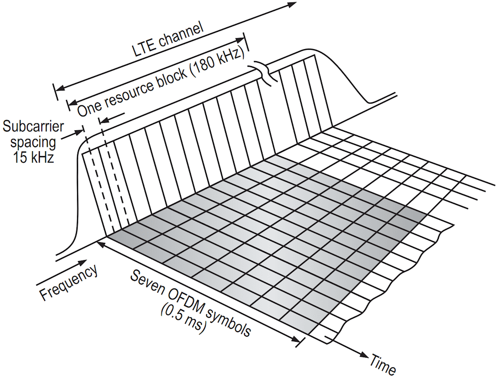

OFDMA is the access technique used in Long-Term Evolution (LTE) cellular systems to accommodate multiple users in a given bandwidth. Orthogonal frequency division multiplexing (OFDM) is a modulation method that divides a channel into multiple narrow orthogonal bands that are spaced so they don’t interfere with one another. Each band is divided into hundreds or even thousands of 15-kHz wide subcarriers.
The data to be transmitted is divided into many lower-speed bit streams and modulated onto the subcarriers. Time slots within each subchannel data stream are used to package the data to be transmitted (Fig. 5). This technique is very spectrally efficient, so it provides very high data rates. It also is less affected by multipath propagation effects.
OFDMA assigns a group of subcarriers to each user. The subcarriers are part of the large number of subcarriers used to implement OFDM for LTE. The data may be voice, video, or something else, and it's assembled into time segments that are then transmitted over some of the assigned subcarriers.
Figure 5. OFDMA assigns a group of subcarriers to each user. The subcarriers are part of the large
something else, and it’s assembled into time segments that are then transmitted over

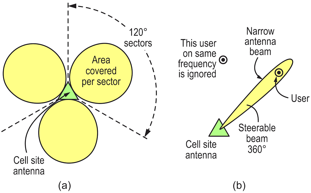

SDMA uses physical separation methods that permit the sharing of wireless channels. For instance, a single channel may be used simultaneously if the users are spaced far enough from one another to avoid interference. Known as frequency reuse, the method is widely used in cellular radio systems. Cell sites are spaced from one another to minimize interference.
In addition to spacing, directional antennas are used to avoid interference. Most cell sites use three antennas to create 120° sectors that allow frequency sharing (Fig. 6a). New technologies like smart antennas or adaptive arrays use dynamic beamforming to shrink signals into narrow beams that can be focused on specific users, excluding all others (Fig. 6b).
SDMA separates users on shared frequencies by isolating them with directional antennas. Most cell sites have three antenna arrays to separate their coverage into isolated 120° sectors (a). Adaptive arrays use beamforming to pinpoint desired users while ignoring any others on the same frequency (b).
Figure 6. SDMA separates users on shared frequencies by isolating them with directional antennas. Most
